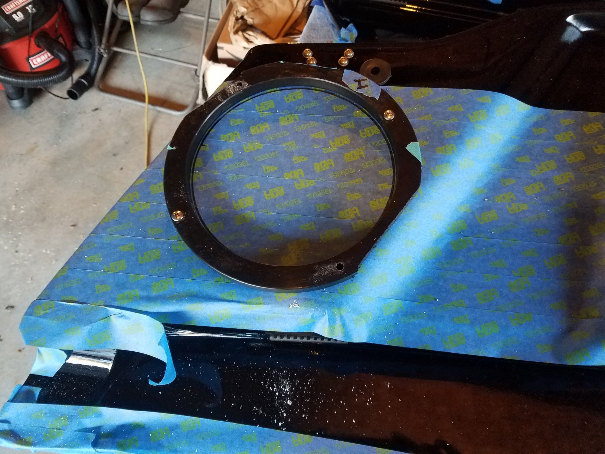

Made some progress today, but i dont want to cut anymore fiberglass until i bring home my respirator from work. Overall the test fit went perfect.
Looking Good, are those 8's? Is this a PreRushmore? I get to start cutting into my bags next week. (Im nervous as heck) Still trying to decide how I want to cut the hole or holes.
Pete
  #65
Old 03-07-2017, 08:09 PM
pdevore's Avatar
pdevore
pdevore is offline
Join Date: May 2015
Location: Minnesota
Posts: 474
Received 34 Likes on 30 Posts
Matt,
Can you show a pic of the outside with the speaker mounted?
Is that ring that you trimmed mounted inside the bag?
After you located that ring and drilled the mount holes, could you then mount it inside and cut it out with a flush cut router bit?
I am trying to decide wether I want to do a full 8" cut out or if I want to do a pattern of 1/4"-3/8" holes.
Thanks for the info
Pete

Originally Posted by pdevore
Matt,
Thanks for the info
Pete

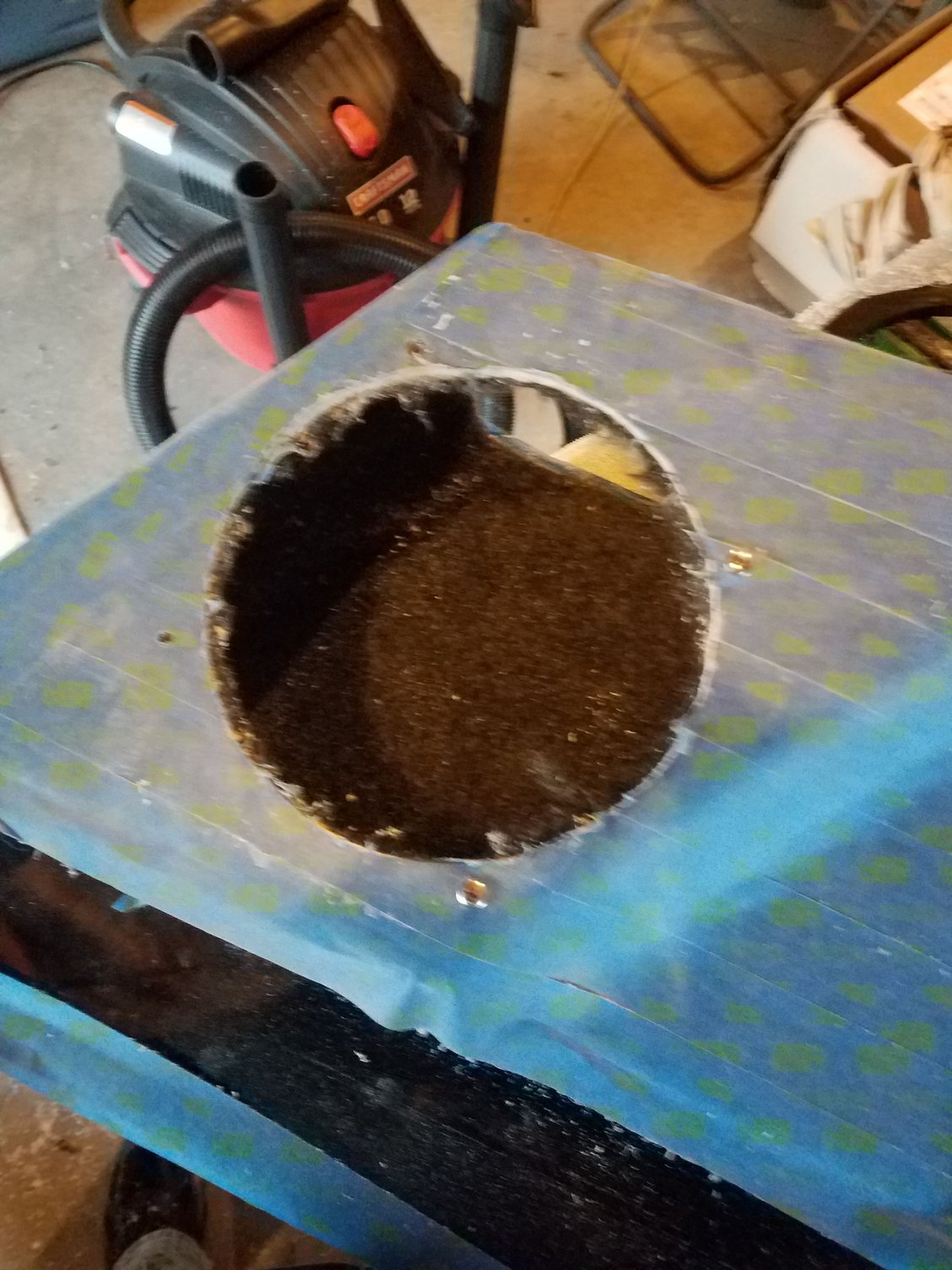

This was a Chris Lowe kit that i bought off a member here. The poly speaker mounting rings were pre taped to show where to cut off some edges to clear the shock hump and back angle of the bag. Once i got that where i needed it i placed the speaker in there where i wanted it and marked as many holes as i could to determine where i could get the best meat of the ring. I drilled one hole and then made a couple marks for alignment when i moved the ring to the outside of the bag and then put a screw in to hold in in place, drilled another hole and put another screw in to hold it in place and so on, traced the inside of the ring and then cut a hole to get my jig saw started. Cut a rough hole and then screwed the ring on the inside to use as a guide and then used my router for the finish cut. I'll take some better pictures tomorrow when I do the right side bag for a little clarification on things.
These are Topshop OEM style stretched bags for my 2015 Street Glide. With 8s I was told you will want to do one big hole vs many smaller holes like 6x9s. No idea why lol, but I am not about to doubt Gann and haze on this one.

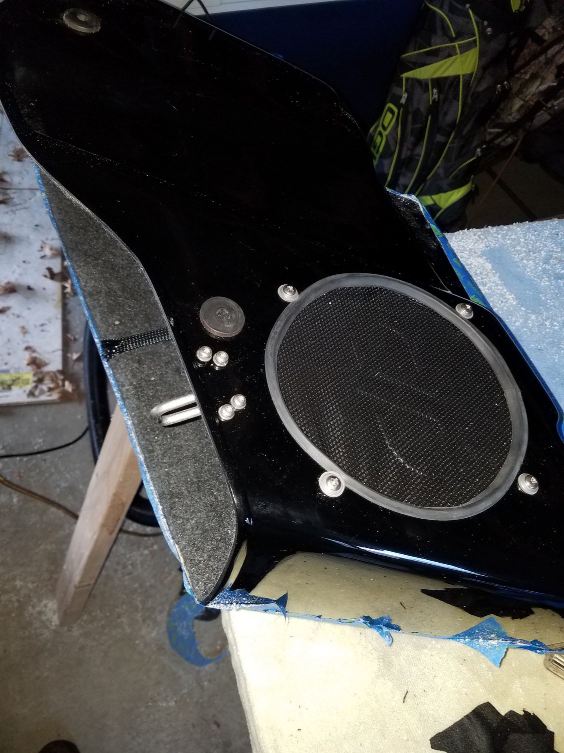

there is a small gasket type ring that covers up the cut and to help seal things off. This was just a test fit, i want ro add treated speaker cloth between the grill and poly speaker ring.

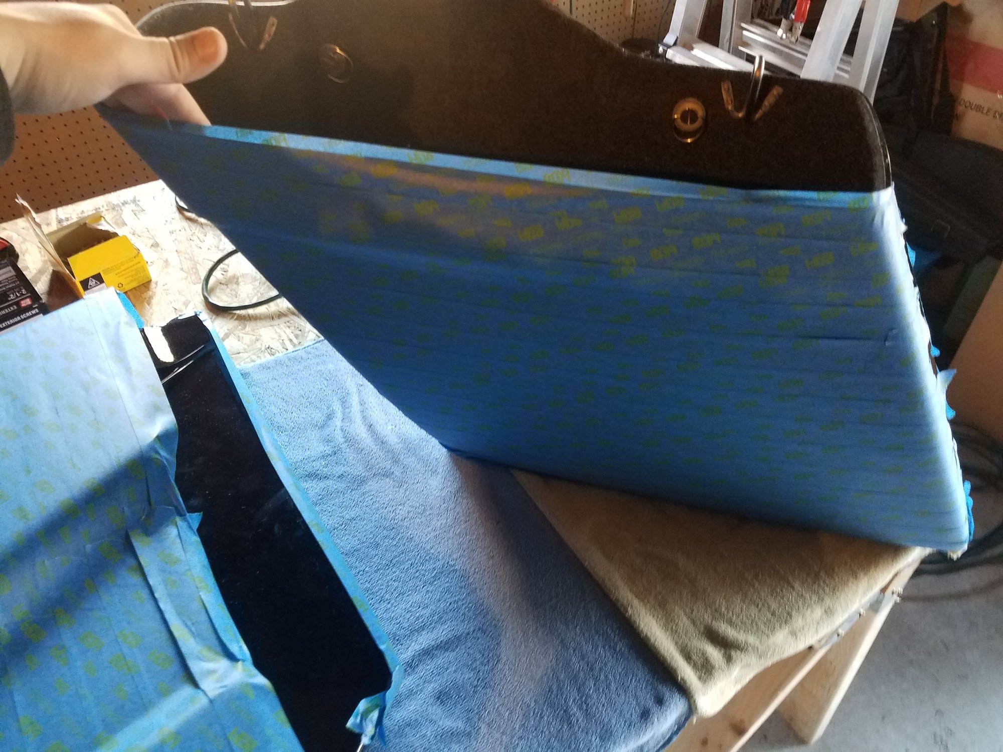

A little more progress today on the right side bag, but having to use generator power since we will be without power till late Saturday. Got the hole cut and will finish when iget some daylight tomorrow.
Here are some completed pictures of the 8" installed. More room left in the bag than i thought there'd be.
The rubber surround was getting hung up on the carpet of the bag.
Amp will be where the wire is going.<br/><br/>More room left than i thought there'd be.
Safety first lol.
