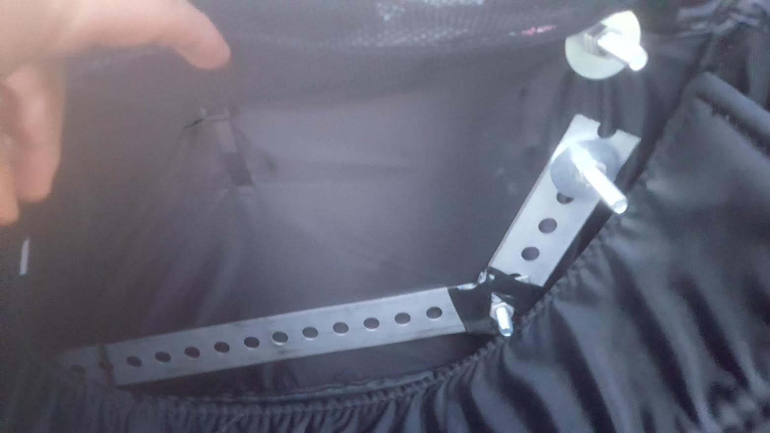

Hey Nightsterept- and anyone else interested:
I'll start off by saying I appologize for not taking a few pics during the process but its super basic setup. Also, this is probably a bit of a rough draft as its not pretty but has function. Tourmaster really did a great job to provide a realitively sturdy backing and seems like they made these specifically for dynas as the left side rests along the beltgaurd and the right fits snug and against the outside back of the brake caliper (with and without the throwover yoke). The frame was just a little assurance to add to the rigidity.
Anyways, I didnt want to attach it using the forward fender strut bolt to allow semi quick detachment in probably 10 minutes or so. I used a square ubolt to ensure it cleared the struts for the front. I also slipped a sleeve of rubber heat shrink tubing around the ubolt to provide a cushion and protect some paint. Using approx 1 1/2" flat stock with holes (5/16") to make an L-bracket to attach to the lower ubolt section. I rigged the ends of the stock with a good bit of black tape to help from rubbing too much into the bags. for the rear, Im still trying to think of a better solution but for now, I ran a piece of black tape on the strut for paint protection and the thickest zip tie i could find.
In posting on here, Im totally open to suggestions. I know its not pretty and plan to at least cut the bolts down a bit.

These pictures kind of scare me...
