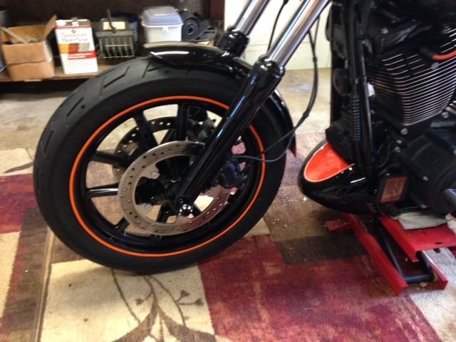

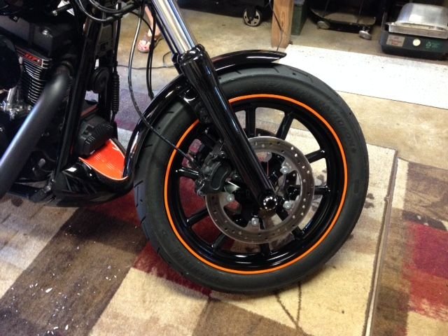

You can buy a brand new set of regular black and polished LR wheels from a discount Harley dealer for $825, plus new bearings, you can reuse the sleeve. Thought of having mine powdercoated but then you gotta remove the tire and pull the bearings also. That also means brand new bearings for about another $100. $300 for powdercoat and about a 10 working day turnaround means a good $400 plus tire removal and reinstallation. So now you are around $500 at least. I decided to paint mine. Got the front one done today. Just gotta finish the orang stripe in the morning when the paint is ready. Total cost $12 for two cans of SuperMaxx paint and $12 for the orange stripes I'm puttin on

Brother, that looks so much better! That baby poop brown on the wheels doesn't do anything for me at all either; it's awful. Your solution is perfect!
Well done

I knew the front rotor bolts were 20 ft lbs. I was thinking the rear was more since it's a 3/8 bolt rather than a 5/16 like the front. The new pulley bolts are always a good idea. Paint was dry enough to mount the stripes and put the wheel back on. What a difference. I'll tackle the rear tomorrow

That's much better than the "gold"...looks slick!

That's just a hot looking bike, you done well!
What's the orange stripe, paint or tape/sticker?

It's actually reflective tape. Adds a real safety factory after dark for those drivers approaching from my side.

The wheels are going to be a great finishing touch. Nice job.

Sweet ride man, can we get a full side shot with the new wheel color? ..Im not in love with my gold rims either.
