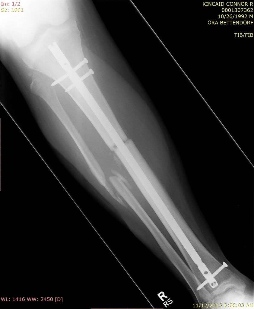

Cat scan of my leg 6 months after the accident, no healing so thats why recovery took so long total of 4 surgeries and 2 different rods to save the leg and get it to heal.

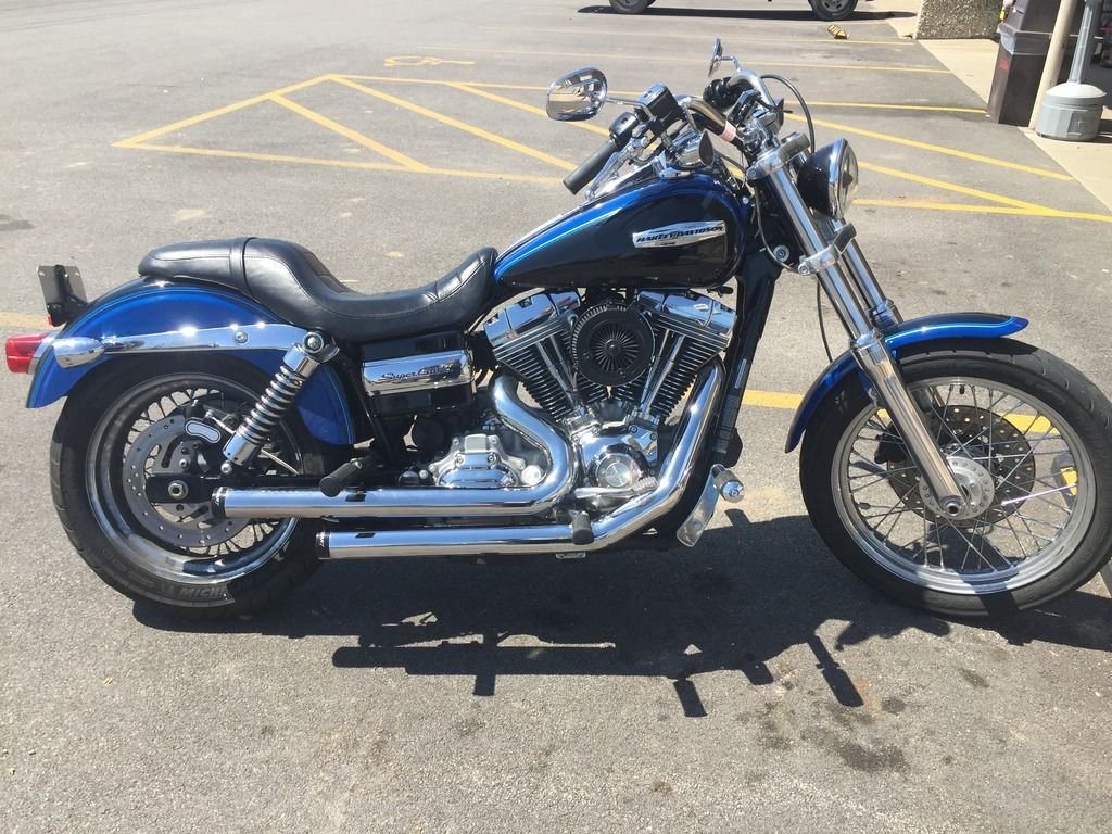

Stock when I bought it

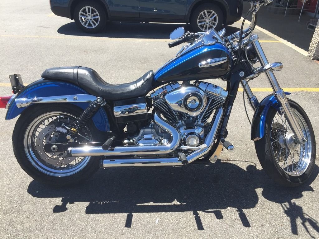

New air cleaner and pines

Posts: 136
Received 6 Likes on 6 Posts
LEgs all healed up and good to go now! Left and pretty gnarly scar but all is good makes for a good story atleast!

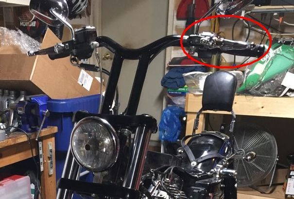

Got the new bars on and they look great! What do you guys think?

The bike looks great and I really like those bars. Sorry about your accident. Be smart about your rehab/healing.
Legs all healed up now accident was a little over 3 years ago now. Loving these bars internally wired and cables were just long enough for these bars. Looks less out of place with the tank on now.

Did I miss it?... Brand and Height of Bars?...They appear lower than a lot on here
