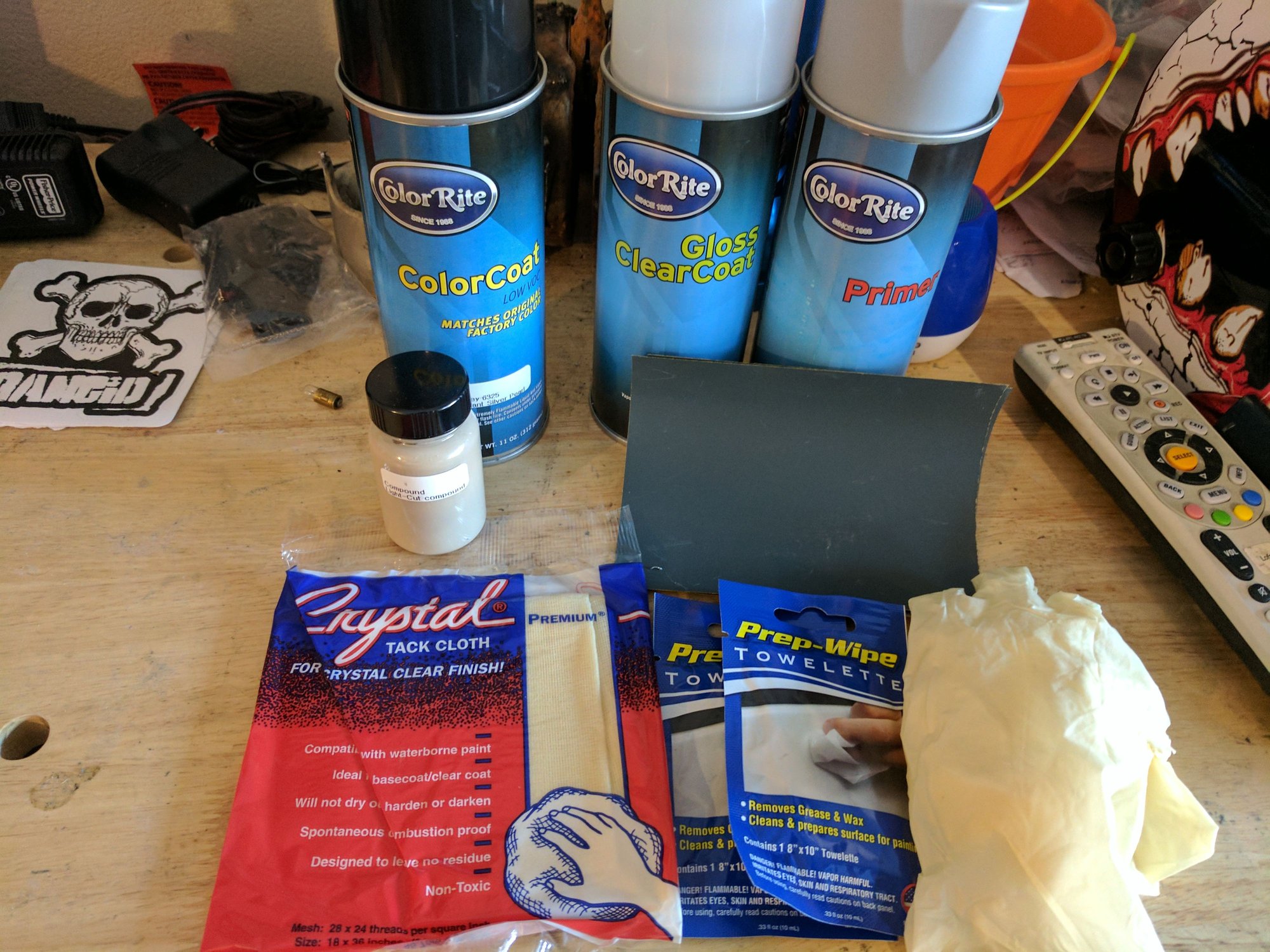

This is the color rite kit. It comes with gloves, sandpaper 600 1500 and 2000 grit. 3m automotive painters tape, some prep wipes, polishing compound, primer, color matched paint and primer. Kit was 79 dollars plus 14 shipping.

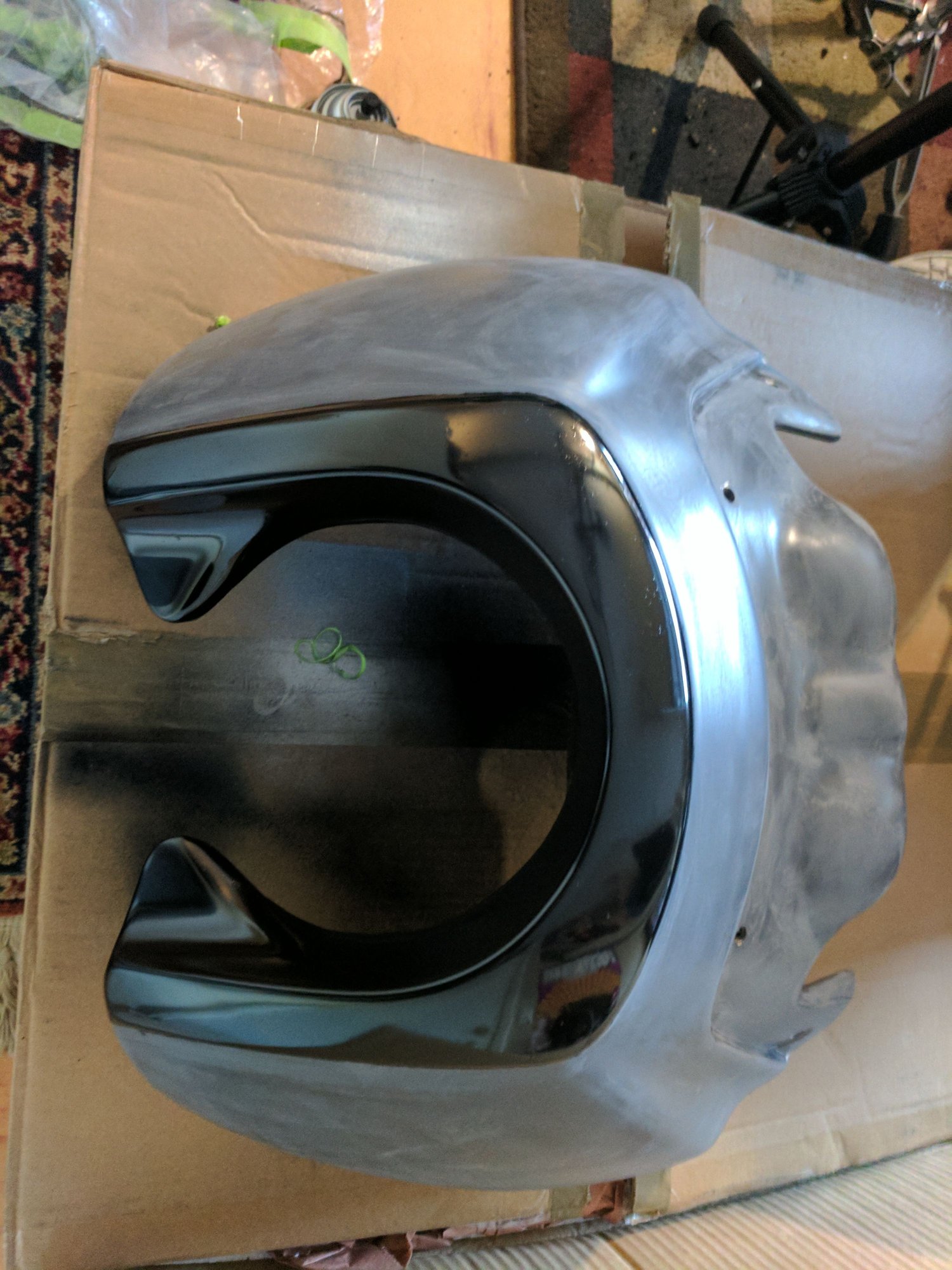

Taped off ready for first black coat. Just some generic gloss black automotive paint from AutoZone.

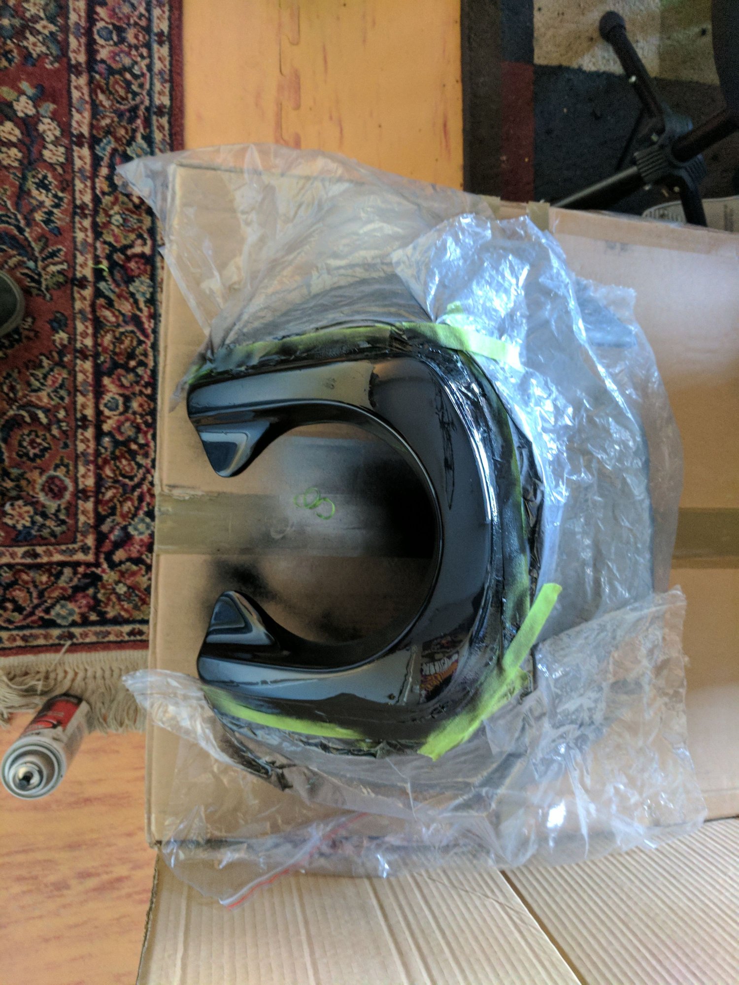

Two coats of gloss black.

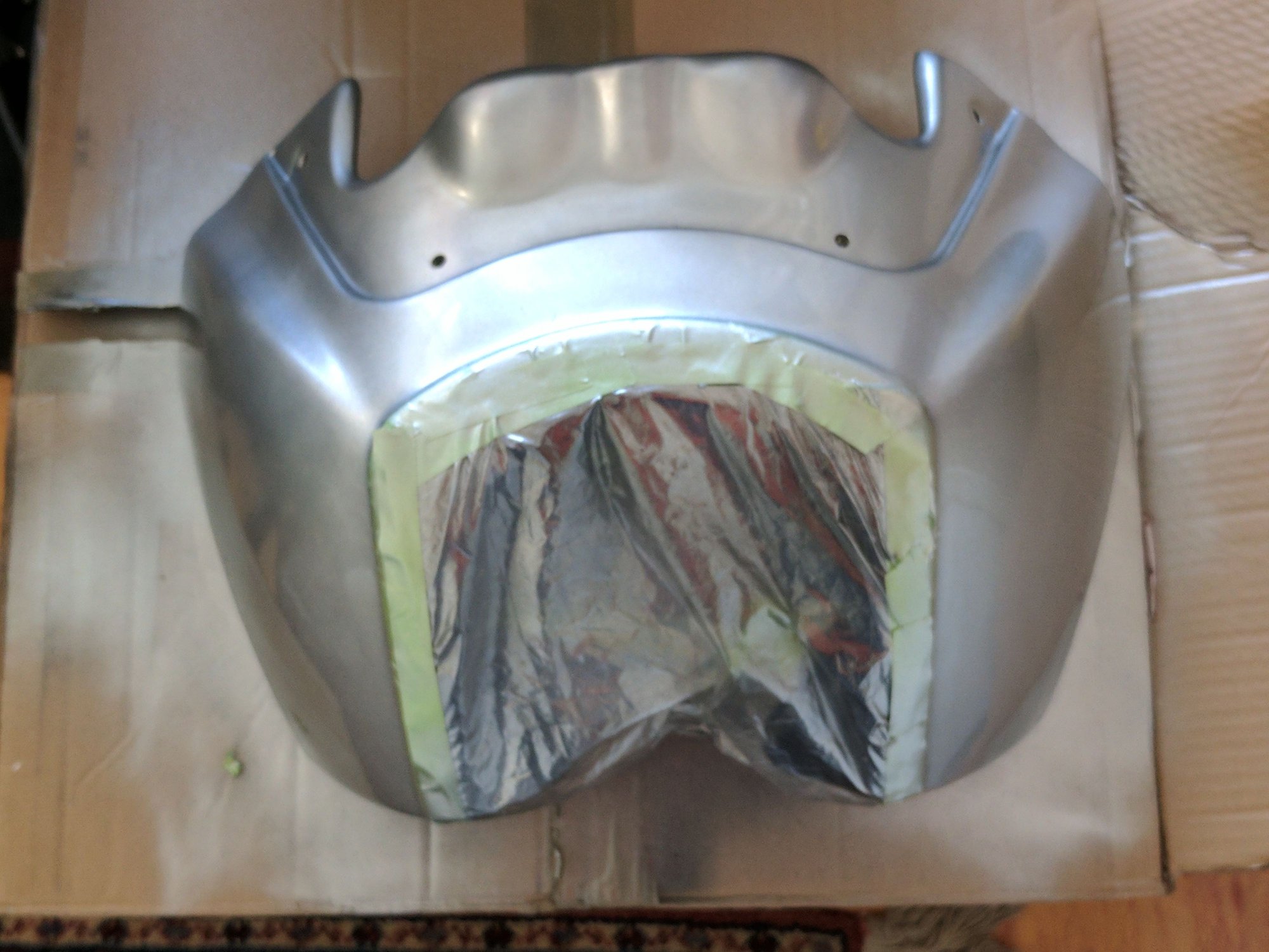

Taped and first coat of color.
