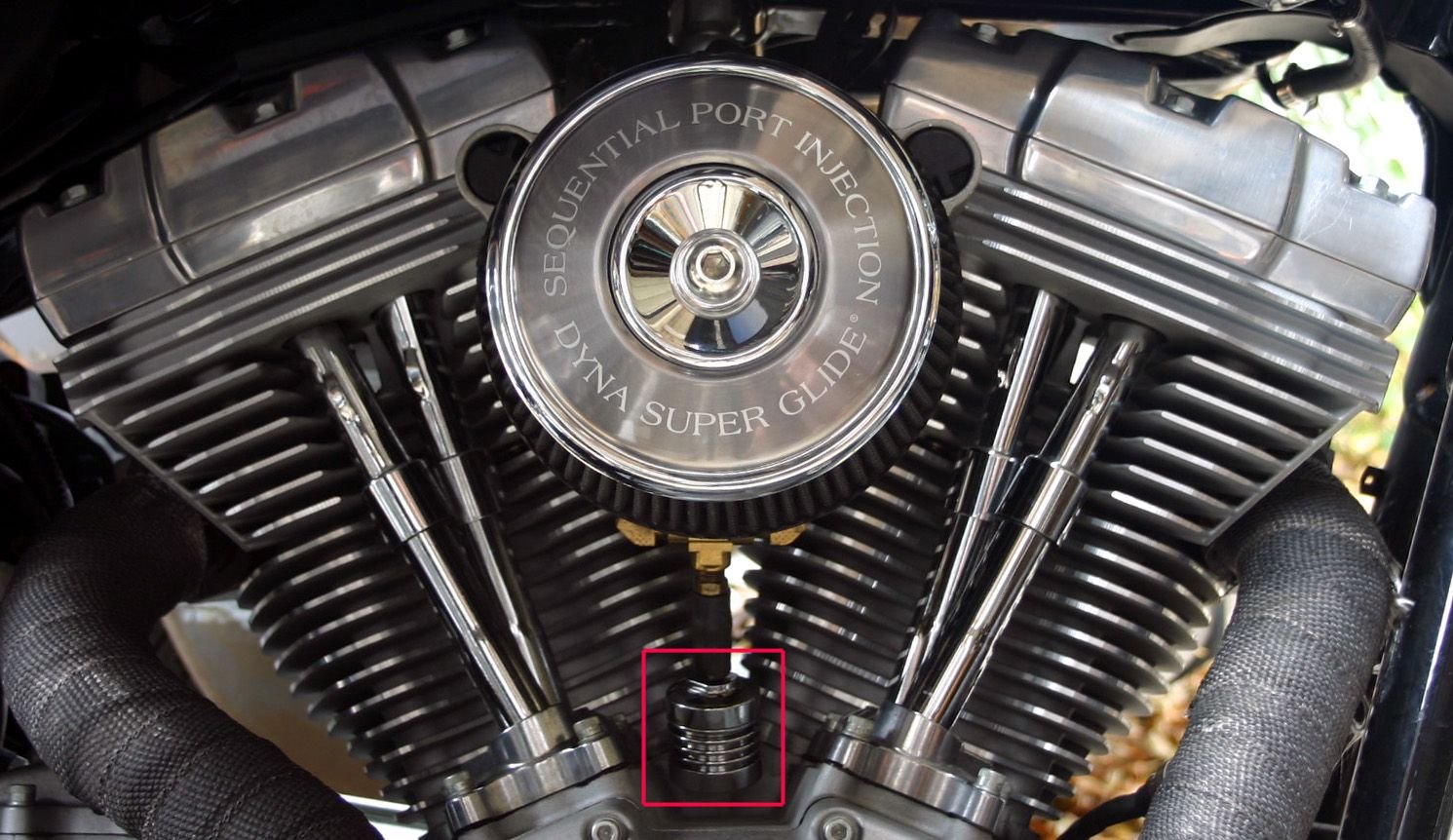

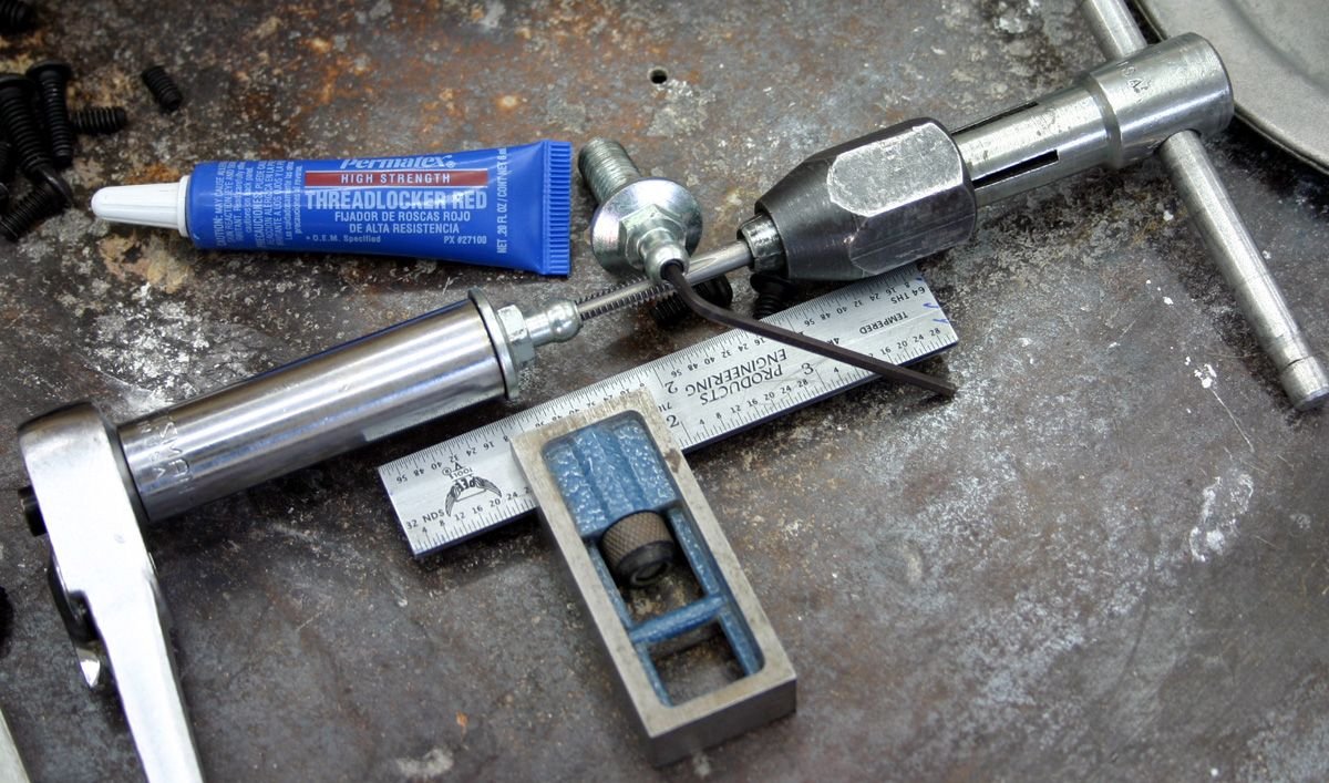

Here's one,
vent your crankcase into the atmosphere,
instead of runnin that muck back through the motor.
Below,
stock bolts, tap both (10-24??) then lock in set screw
Below,
set up fixture for drill pressing in proper location
Below,
drilled in this direction as well as opened up a little lengthwise
Below,
hose fittings
tapped for 1/8" pipe. the one on the left won't work
Below,
backside
catch can about 20 some odd dollars. hose and brass maybe 10 bux
Below,
DONE
one more view, probably about a half day rounding up parts and takin my time
