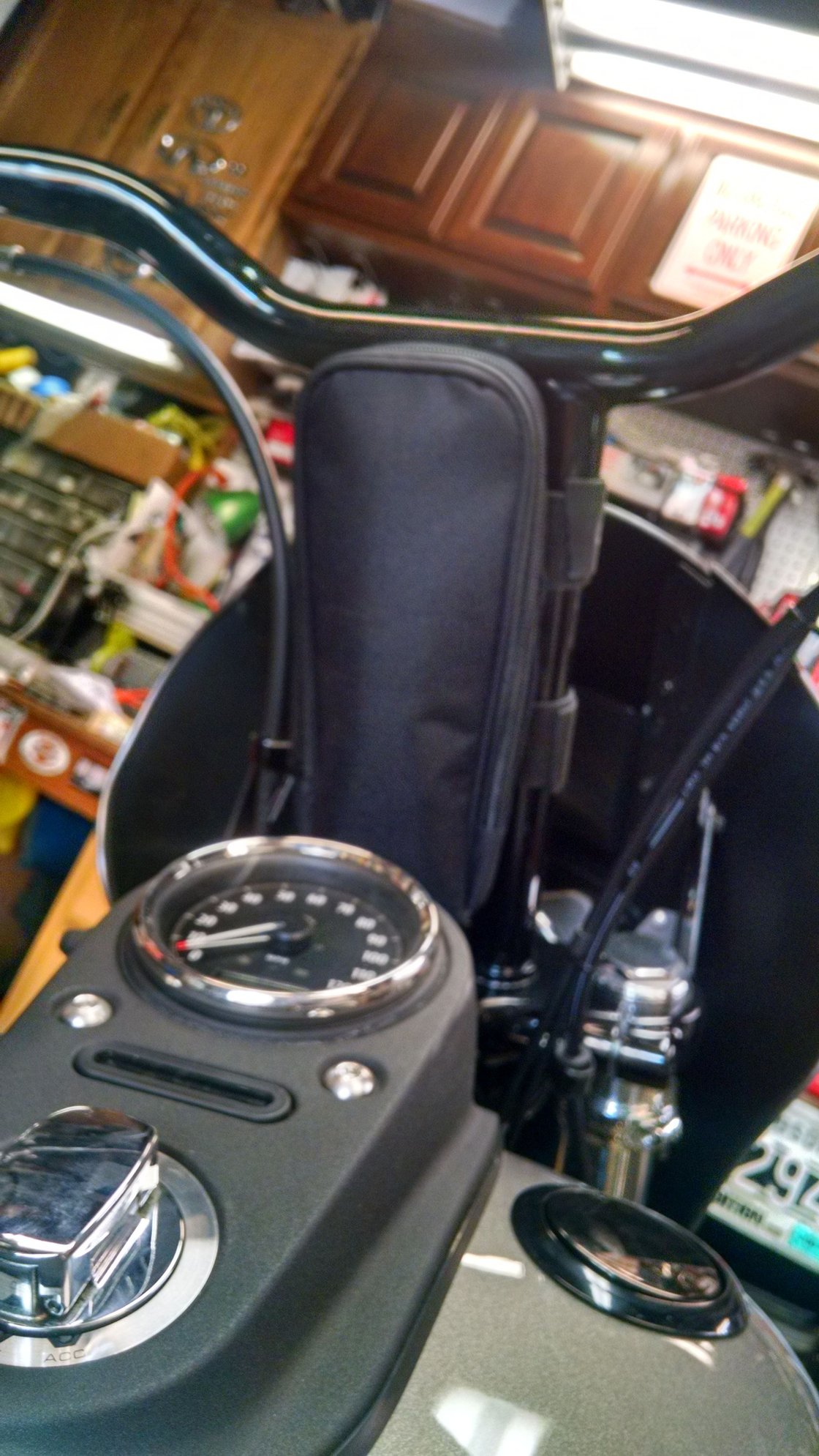

T-Bar Bag for about $15.00
Item 1. Klein Electric Tool pouch part# 69401. I picked it up at my local Platt Electric for $6.81 out the door.
Item 2. Double sided Velcro. I purchased 1 yard at my local Joanns fabric for about $3.00. (You might want to send your girlfriend since you will be the only guy there.)
I removed the Klein patch off of the front of the bag and sewed the double sided Velcro with the soft side against the handlebars. I'm thinking of sawing on maybe a Harley Davidson patch's or something since you can see the impression from the tool patch. All said and done I'm happy with it. It's a great spot for sunglasses, gloves, and phone charger. I left the belt strap on it so if I'm out I can hook it on my belt and not worry about it getting stolen of the bike. (I did have my gas cap stolen at Street Vibrations this last September so I'm extra cautious. $78 bucks for a new one.)

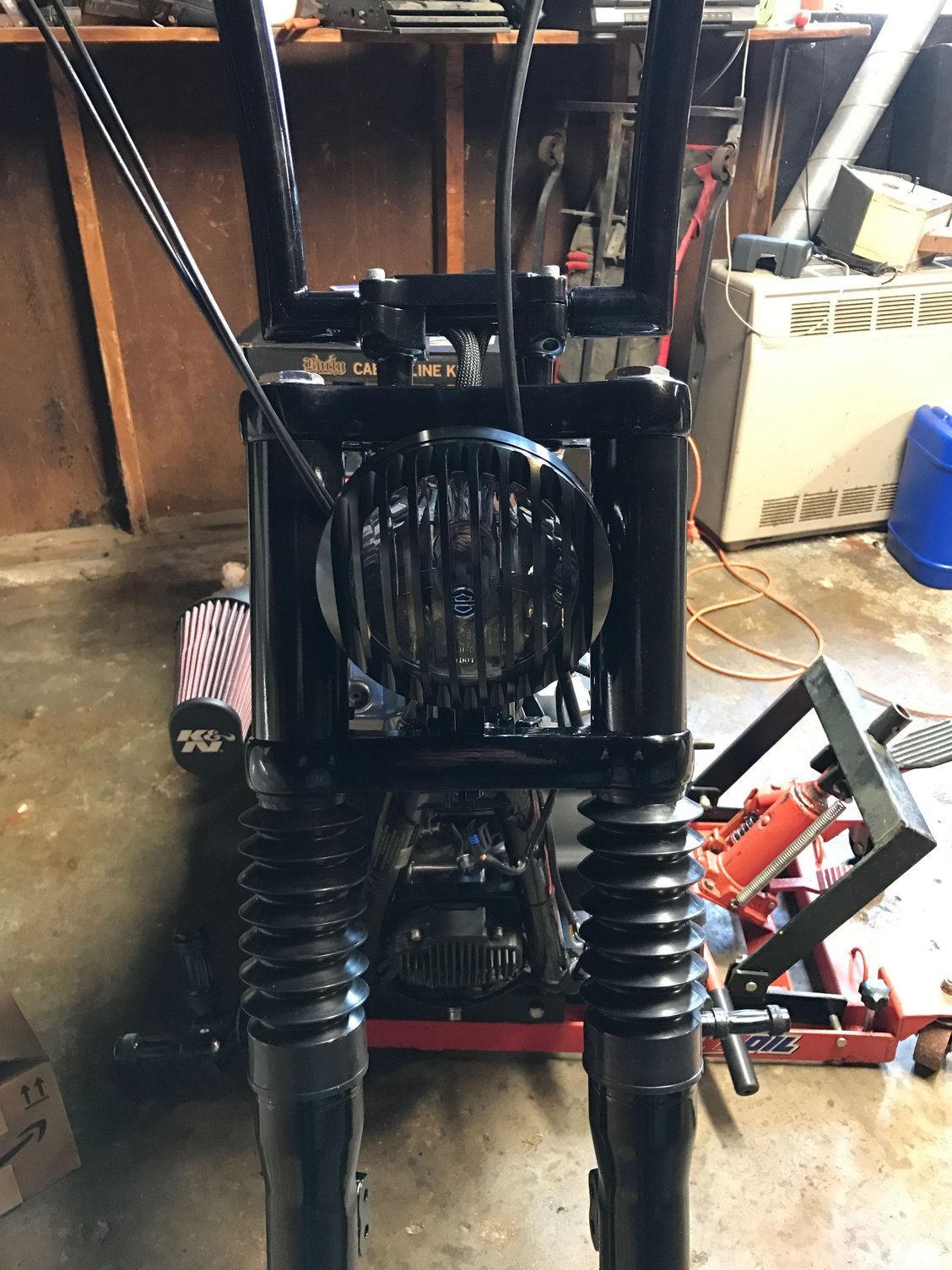

I didn't read through all 215 pages so I don't know if this was mentioned already. I cut 2" sch 80 pvc to length for 49mm fork tube covers between the trees. Painted them black and used o rings to keep them tight
