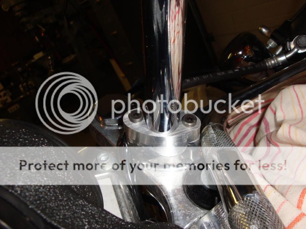

Step 1: We assume you are replacing the original bars and they are off already. Secure front wheel, preferably supported in a wheel chock; put a jack under the front end of the frame and lift to the point that most but not all the weight is off the front wheel.
Step 2: Remove the two torx head screws from each side of top piece of your triple tree. Remove the screw securing the the brake line to the triple tree. Unscrew the large chrome cap that covers the center bolt on top of the tree. Remove 1 1/2" nut (this socket is not in most tool kits but the socket and 3/4 to 1/2" adapter can be had for less than $15) and washer.
Step 3: I used a small rubber mallet to bump off the old top tree, and put the new one on (I bought mine from Lonerindustries). Reverse the steps to put the new one on remembering to put some new locktite on the torx screws.
Now you have unlimited options for bars including the WO560 drag bars that are now on my wife's 2008 Street Bob.
