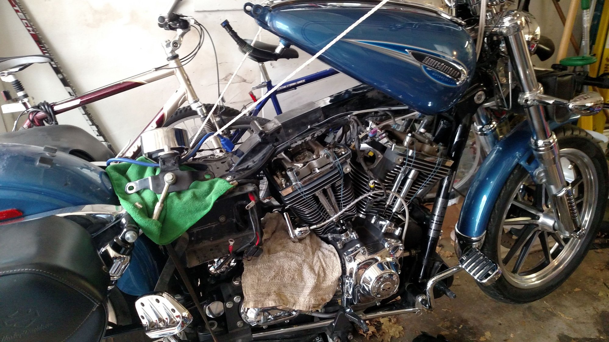

Turning into a build thread. Here are my first couple days stages down to the boxes then to the cylinders:
The only real notable tip I have is you will want the s shaped allen wrench for the right side throttle body bolts: http://www.homedepot.com/p/InSinkEra...N-00/100135761 they are a pain to reach and having more angles get to them in that tight space helps.

Here are the heads. They are going off to The King of Cubes in Des Moines to get pocket porting, cleaned up, and compression releases put in:

By the suggestions both on the thread and in my head I am also having the same shop bore the cylinders out to 3.975 to fit the pistons that djl suggested and targeting that 10.08/9.35:1 ratio. Will be taking the cylinders and pistons off this week.
