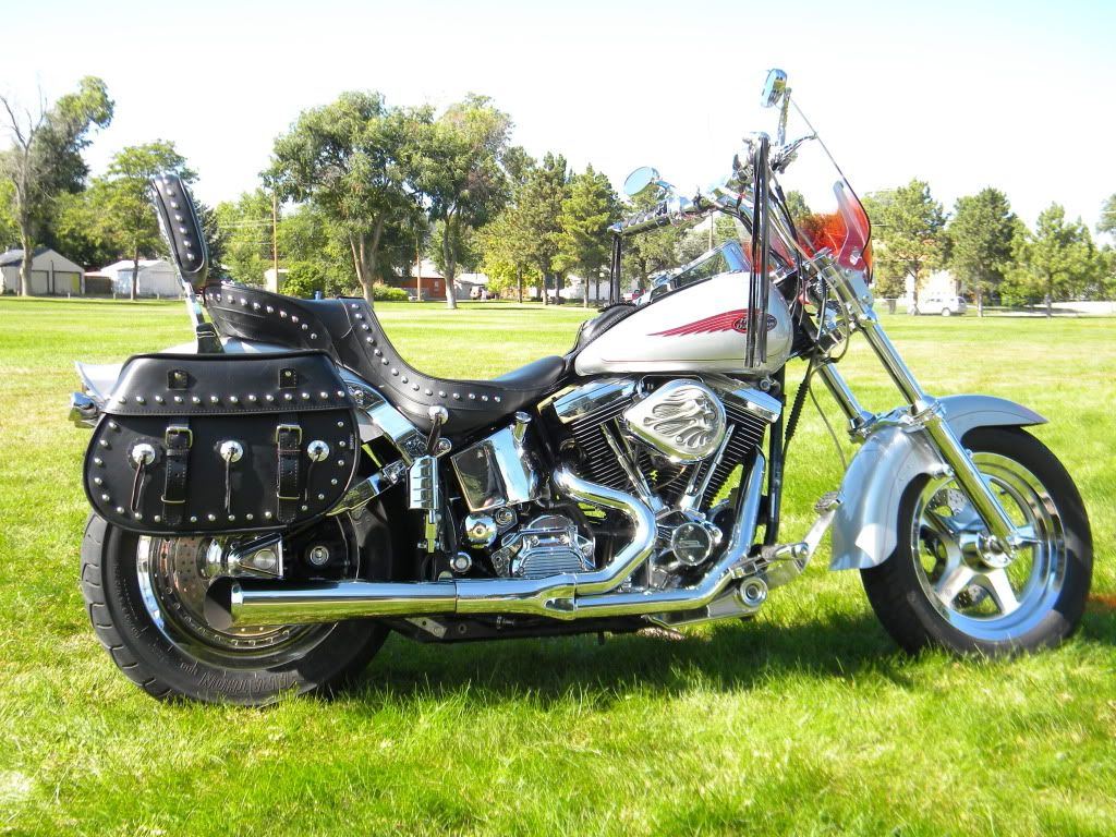

Old 07-13-2017, 03:47 PM
Jaws77's Avatar
Jaws77
Jaws77 is offline
Join Date: Jul 2017
Location: Minnesota
Posts: 63
Received 0 Likes on 0 Posts
Originally Posted by 1931jamesw
Get a mikuni hsr 42 carb and a andrews 27 cam as stated above for what you are wanting to do. Also a 2 into 1 exhaust as stated above.I would also get a k&n type air filter and adjustable pushrods. All evo cams are gear driven.
Hey JW ! Like you described my mods to a T.
Same cam, same carb (rejetted), k&n, screaming eagle ignition, v&h straight shots (2 into 1 gone for looks & sound although you're right about the performance). If you're still around I was just wondering what kind of HP I may be generating.
89 softtailC with 2nd gen Evo. Thanks & hoping ya can give me a ballpark. 69.5 outta factory.
