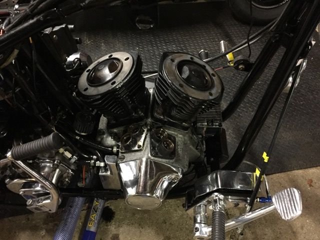

Got started on my teardown today and made good progress. These things are easier to wrench on than Twinkies as there are no real electronics.
Console off, tank off, carb off, pipes off, associated bits and bobs off, then heads off.
Those Shovel head bolts can be a pain to get to - but ingenuity won the day in the end.
So here's some pics!
Here's where we are at right now....
And a bit more detail:
Heads on the bench now they are off. Planning to send out for a valve job, but also to clean them up with vapour or bead blast - then refinish somehow but I don't know how - should it be powder coat or what? I'm a bit worried about the high temperature....

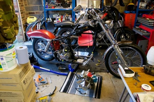

A little update on progress, which is slow due to the cold weather here. However - my wife made an excellent suggestion yesterday. She said:
"Why don't you bring the bike into the house and work on it there".
I was stunned. Never thought she'd say that in a million years, and didn't bother even suggesting it. I love my wife!
So - once the bottom end, primary and tranny are all out, I will wheel it in and stick it in the spare room. Excellent!
Anyway...back to the matters at hand.

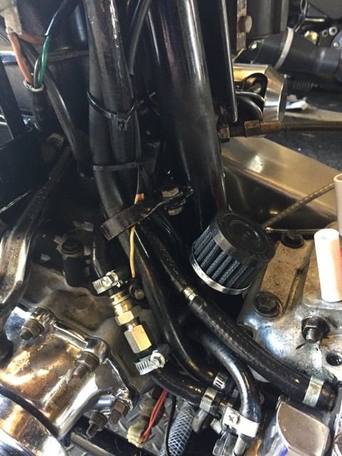

First, I took off all the oil lines and breathers between the motor, oil tank and primary. That was a bit of a rat's nest that had been cut and joined in many places over the years. New braided oil lines on the rebuild and a sealed primary should clean the look up there.
I took the right hand side foot controls off, then the starter and starter solenoid followed by the inner primary.
That was a bit of a bugger as although the primary was loose, it didn't want to clear the tranny. Puzzled me for a minute until I realised there was another casing part bolted to the back of the primary that carries the gear between the starter itself and the shaft that leads into the primary. I got that off easy enough once I realise that was the obstruction.
