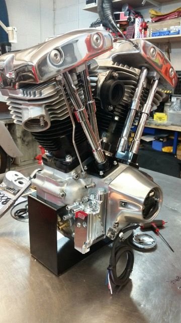

Well, slow progress as I have been away with work and will be away next week as well. But the engine is done. Now i just need to go and pick it (and the gearbox) up. Can't do that until next Friday unfortunately....but if I play my cards right i will manage to get the engine and frame in my car on the same run and then the fun can start.

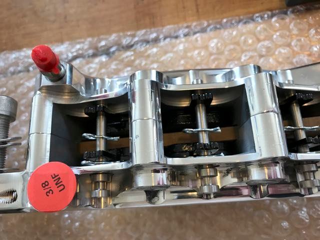

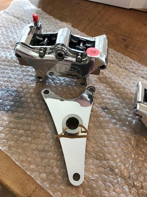

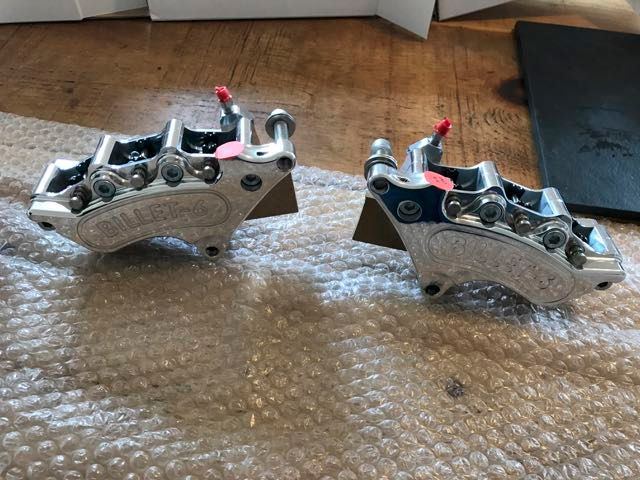

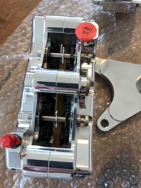

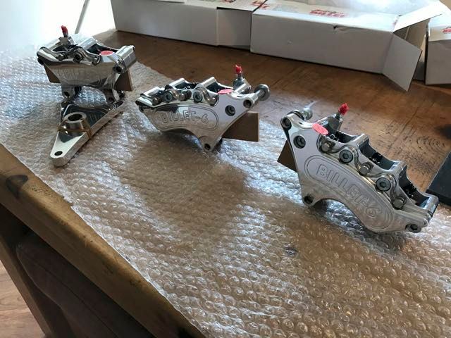

I spent some more money this week! Ordered a set of Harrison Billet brakes.....
2 6 pot callipers for the front, and a 4 pot and billet bracket for the rear. Like these:
Oh - and a pair of Hagon Nitro shocks for the rear. Need to decide what to do at the front though....

Oooh look! Some shiny parts have just arrived....
Harrison Billet (UK firm) 4 pot caliper and bracket for the rear, plus two 6 pot callipers for the front. They look like a work of art.

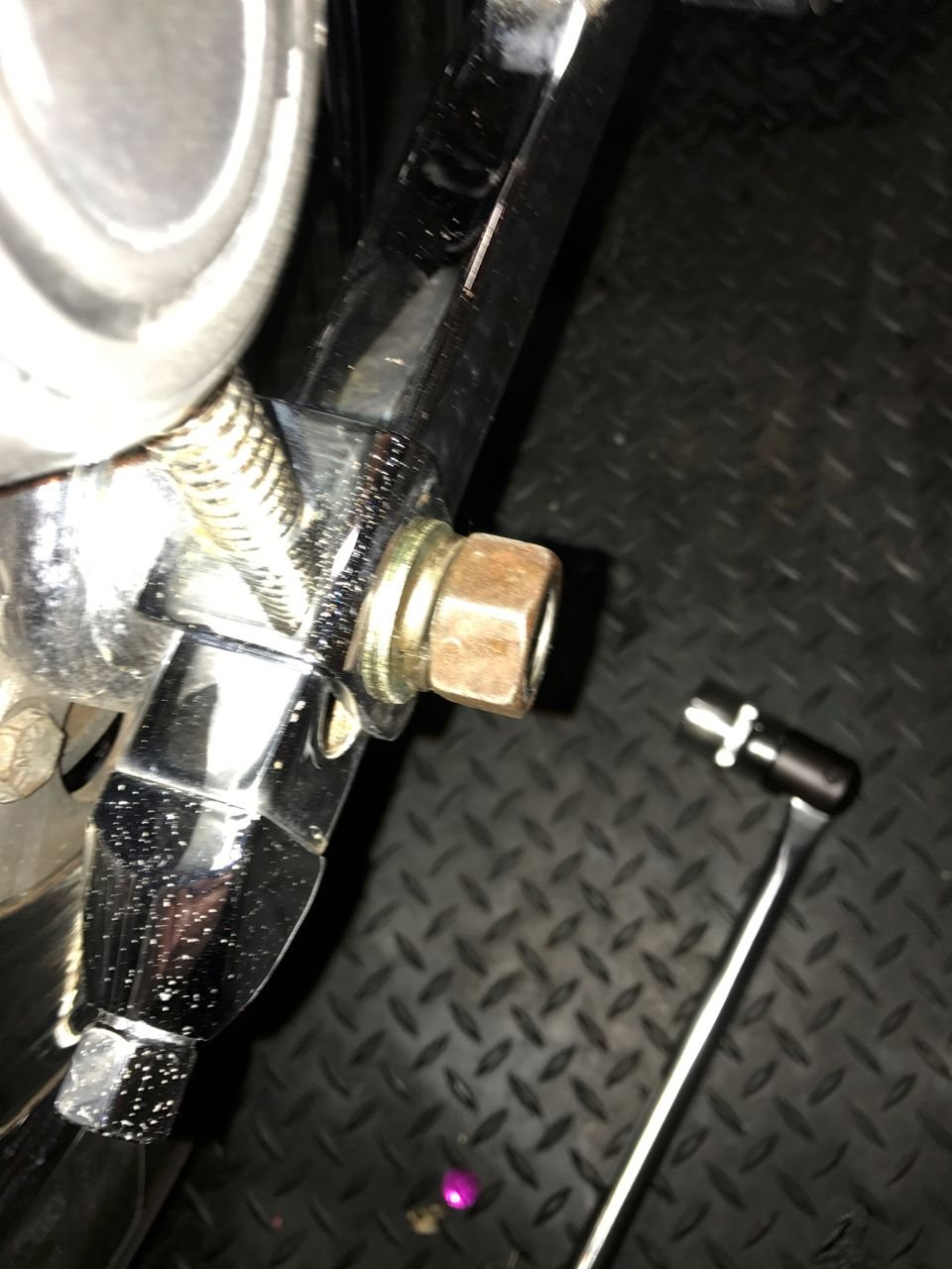

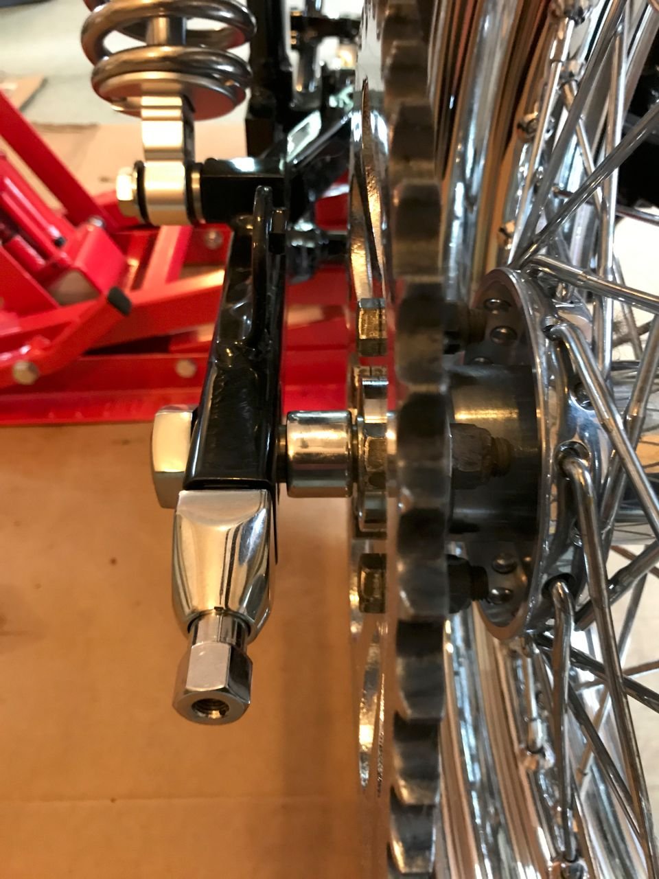

I did a trial fitting of the rear wheel - and just wanted to check it is all correct before proceeding...
Here's a couple of pics of how it was set up before I tore it down, followed by a few of the "now" situation.
Before teardown
Current situation
This looks correct from the parts manual as well. From the left side, the axle goes in through the axle adjuster, then a spacer, then the rear wheel, then the brake carrier, then through the right axle adjuster then a thrust washer, a spring lock washer and finally the axle nut.
Now - there's a gap of approx 1/8th inch between the left hand spacer and the swing arm. I haven't tightened the axle nut yet and I presume that this will pull the swing arm ends in to close this gap. Is that about right or should I be looking at a slightly longer spacer there? And there's no washer between the axle bolt on the left and the left side of the swing arm - is that also correct?

I would try the calipers on, bled and ready, to see if that moves the caliper bracket bracket anymare... you may need shim on that side.
As far as I know, you don't want the swingarm to flex, but everything in between the 2 arms has to fit right.
You MAY also need shims on the sprocket side to align the chain?
