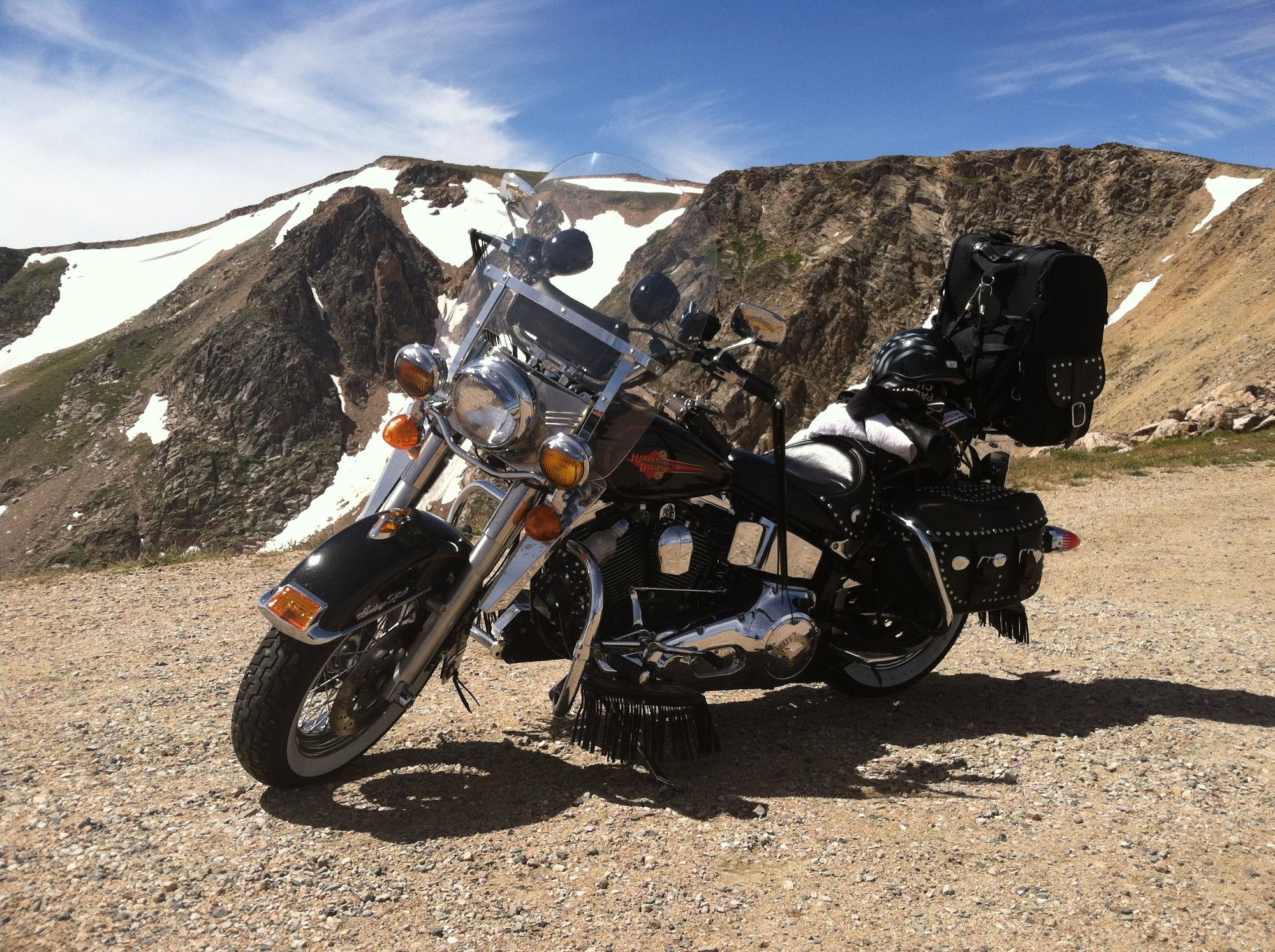

I do a lot of highway driving and am tired of numb hands and feet from all the vibration above 70 mph. I own a 93 FLSTC and am looking to replace the trans with a 6 speed. I have read many of the posts on the site regarding many of the brands, Baker, Jim, Revtech, Ultima, ect. I don have the budget for a Baker or Jim. My bikes engine is mostly factory other than exhaust, re-jetted carb and a big sucker cleaner. I have seen a few posts on the Ultima and Revtech. However many are over 5 years old. Has any one had some failures, excessive gear noise or hard shift issues with the less expensive 6 speedsb lately? Any info would be much appreciated.
