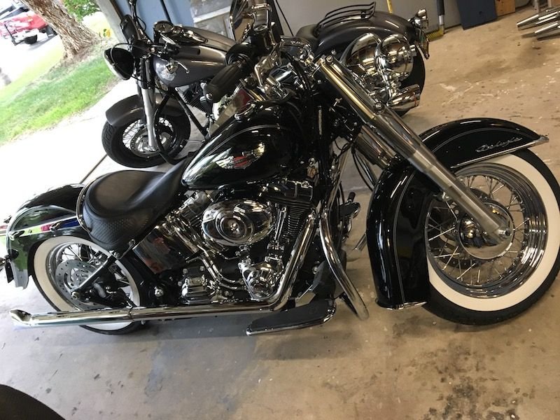

I have the V&H true Duals. I did wrap the baffles with fiberglass, because I wanted to remove some high pitch that bugged me. I do enjoy them and think they look great on my 06. Here are some pics to give you an idea.
The Sporty is the wife's
