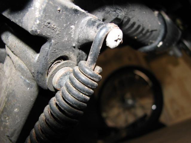

I went over a curb that I underestimated a broke off the nipple on the frame mounted kickstand tab
I knew I was screwed from the onset. After doing some research I read where a couple of people tapped the remainder of the post and threaded a screw while using red loctite to secure it.
Other than welding a screw head onto the tab, does anyone have any other suggestions?
Also if I were to tap and thread a screw into it, does anyone know what size to use?
Full disclosure, I've never used a tap and die before. That said, I'm decent with tools. I would grind what's left of the tab flat before drilled the hole and tapped it. Again, I'm a complete novice with that.
What drill bit would I use? Should I center punch before I drill? Will red loctite work? Is JB Weld something I should use after the screw is inserted with the red loctite?
Are there any other tricks or recommendations?

Grind it flat. Use a center punch. I'd use a screw about half the diameter of the space your working with or a little smaller. Tapping is easy. Take your time. Once it's started and really cutting I go half turn forward quarter turn back. Loctite is a given.

Another question: is a 7/32" drill bit the proper size for a 14"-20 tap? Thanks again!

Looks like 13/64. ​​​​​​​http://www.lincolnmachine.com/tap_drill_chart.html

You can use self tapping screws for steel. Here are some in SS. Run one in. slowly back it out and put some red loktite on it and screw it back in.
https://www.grainger.com/category/ecatalog/N-1z0ds8k
Make sure the ones you get look like this on the tip.
