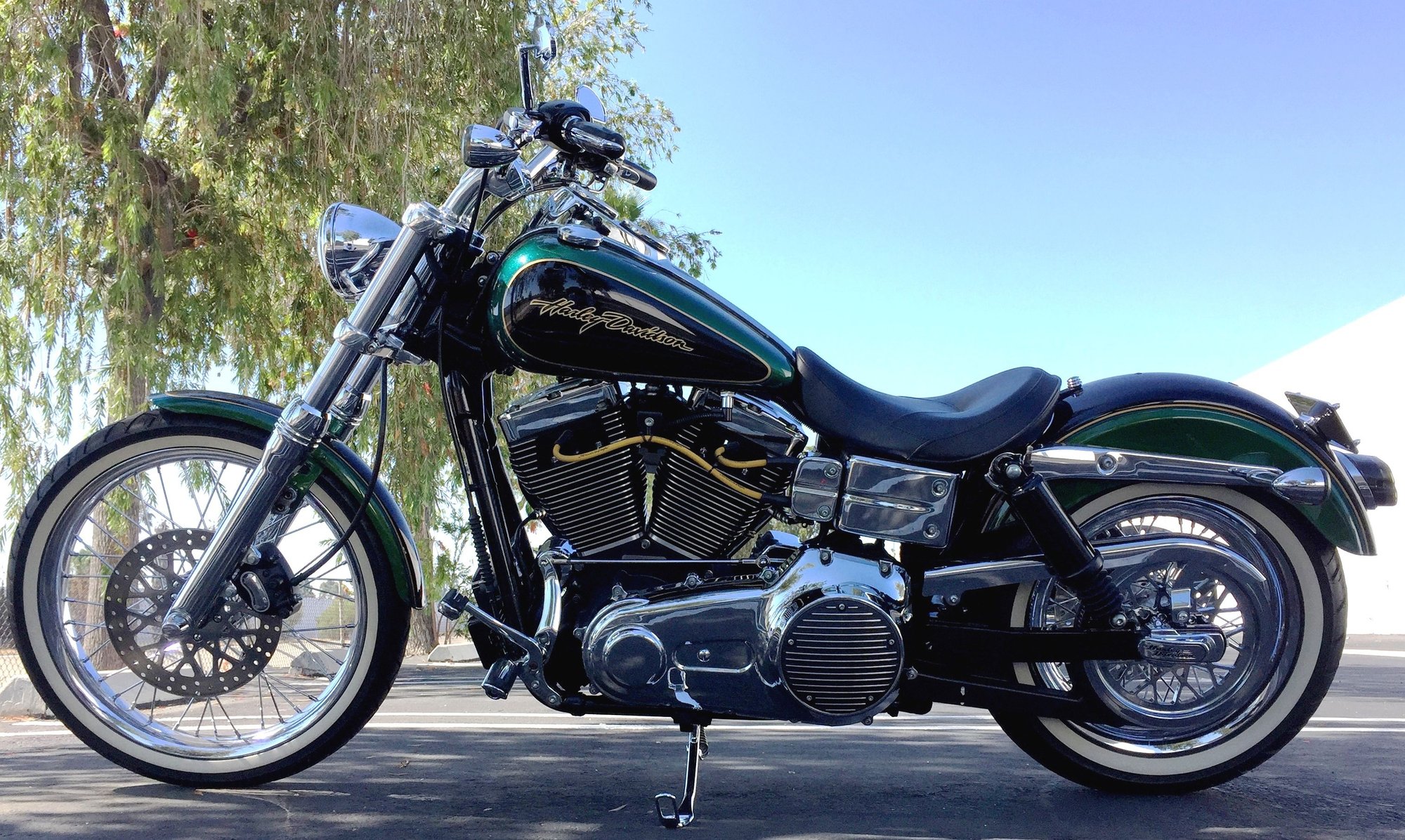

2006 Harley Davidson Dyna Low Rider
Dragonfly Green Pearl & Vivid Black
(Custom paint 1 of 233 only available Jan - Mar 2006)
(Before photos have reflectors and belt guards removed)
**Front End**
*H.D. 2006 Wide Glide 21" front wheel P/N 43563-06
*H.D. 2006 Wide Glide triple clamp upper P/N 46700-06
*H.D. 2006 Wide Glide triple clamp lower P/N 46386-06
*H.D. 2006 Wide Glide axle P/N 40923-06
*H.D. Chrome Tapered Front Wheel Spacer Kit P/N 41410-06
*H.D. Chrome Lower Fork Sliders P/N 46589-06A
*H.D. Billet Fork Slider Dust Covers P/N 46889-06
*Race Tech Gold Valve Cartridge Emulators P/N FEGV S4901
*Kuryakyn Front Axle Nut Covers P/N 1213
*H.D. Tinted turn signal lenses P/N 69304-02
*Painted turn signal reflector and internal housing flat black
*H.D. 2008 Screamin Eagle Dyna front turn signal mounts P/N 68266-03
*H.D. Classic Chrome Brake Caliper Insert P/N 44477-99
* DNA 11.8" Mesh Rotor
*Lyndell Gold+ Brake Pads P/N 7195
*H.D. 2006 Deuce headlight P/N 69715-05
*H.D. 2006 Sportster Custom, headlight mount P/N 67919-96
*Sylvania Silverstar H4 bulb
*Added a bushing between the lower headlight tabs (So tabs will not bend over)
**Hand Controls**
*H.D. Aileron Hand Grips P/N 56425-02
*H.D. Slotted Hand Control Lever Kit P/N 45459-07
*H.D. Chrome Switch Cap Kit P/N 71804-03
*H.D. 2008 Screamin Eagle Dyna Mirrors P/N 92344-08A & 92345-08A
*Added a relay connected to high beam lead to trigger garage door opener
*Routed control wiring inside handle bars
*Routed front frame and console wire harnesses to left side of the bike
*Redressed all harnesses, cables, and hoses
*Removed reflectors, all factory decals, VIN, and emissions labels, and vapor canister
**Tank**
*H.D. 2008 Screamin Eagle Dyna Spun Aluminum Face 4" Speedometer - MPH P/N 67516-04B
*H.D. 2008 Screamin Eagle Dyna Spun Aluminum Face 4" Tachometer- RPM P/N 67522-04A
*H.D. Smooth LED Fuel Gauge P/N 75237-03A
*Tank lift 1.60"
**Engine**
*Arlen Ness Big Sucker I air filter kit P/N AN18-505
*Cut off the original air filter outer cover
*D&D Fat Cat 2 into 1 exhaust with quiet baffle P/N 496-32B
*H.D. Screamin’ Eagle Performance Exhaust Gasket Kit P/N 17048-98
*H.D. Screamin Eagle Race Tuner P/N 32107-01E
(base map # 141NX002 is for 8* injectors but using 25* injectors, +AFR, +VE, +Timing, - Cranking Fuel, - Idle, +Accel Enrichment, - Decel Enleanment)
*H.D. Screamin Eagle Yellow 10mm spark plug wires P/N 31987-85B
*Home made spark plug wire supports
*H.D. 10 Row Oil Cooler P/N 26110-05
*H.D. Chrome Oil Filter P/N 63798-99A
*Billet finned timing cover (from eBay seller gregg5869)
*Relocated horn using rear engine mount bolt
*Installed banana jack on bottom of coil cover for battery tender
*H.D. Script Battery Cover Band P/N 66443-06
*H.D. Screamin Eagle Compensator Kit P/N 40274-08A
*H.D. 40 Amp Stator P/N 30017-07
*H.D. Chain Tensioner P/N 39929-06B
*H.D.Primary Cover Gasket P/N 60547-06
*H.D.Primary Tower Gasket P/N 63869-06
*Bikers Choice derby cover P/N 19-006 Torqued to 30 in. lbs.
*Cometic Derby Cover Gasket - 5-Hole P/N C9997F1
*Amsoil 20W50 Synthetic Motorcycle Oil (Engine) P/N MCVQT
*Amsoil Automatic Transmission Fluid (Primary) P/N ATFQT
*Amsoil 75W140 Severe Gear Oil (Trans) P/N SVOQT
**Foot Controls**
*H.D. 2005 Forward control kit P/N 49080-03
*H.D. 2006 Polished Stainless Steel Gear Shift Linkage P/N 33815-06
*Removed the original shift lever without removing the primary
*H.D. 2007 Screamin Eagle Springer foot pegs P/N 52317-07
*H.D. 2007 Screamin Eagle Springer brake pedal P/N 42574-07
*H.D. 2007 Screamin Eagle Springer shifter peg P/N 49268-07
*H.D. 2007 Screamin Eagle Dyna Polished Stainless Steel Footpeg Mounting Pins (2 sets) P/N 42679-01
*Grinded down rear foot peg stops so pegs will tilt in more when in the up position
**Rear End**
*Custom Chrome lay down pyramid license plate mount P/N 14199
*Trimmed license plate to fit inside mount
*Kuryakyn Deluxe Smoked Tail Light P/N 4974
*Painted LED light face plate and inside of lens sides flat black
*H.D. Street Bob Seat P/N 51475-09A
*Green Pearl Seat Retaining ****
*Modified Lower Belt Guard
*H.D. Front Belt Guard Bracket P/N 49216-06
*DNA 11.5" Polished Stainless Mesh Rotor
*DNA Chrome Mesh Pulley
*Vulcan Works 7/8" Pulley Spacer
*H.D. Chrome Tapered Rear Wheel Spacer Kit P/N 41411-06
*H.D. Script Rear Axle Cover Kit P/N 44346-06
*H.D. 2007 Street Glide Air Shocks (12") P/N 54631-02B
**Tires**
*Avon Venom 90/90B-21 FRONT (AV318)
*Dunlop Screamin Eagle Rear GT502 180/60B17 P/N 43197-04A
*Rear Fender Inner side plate brackets x 2 each, P/N 59514-06
**White Walls**
*Shinko 90/90-21 P/N 87-4565
*Shinko 160/70-17 P/N 87-4602
*Dunlop 21" Inner tube P/N 43140-80
*Dunlop 21" Rim strip P/N 43939-89
*Dunlop 17" Inner tube P/N 40502-06
*Dunlop 17" Rim Strip P/N 43101-06
*Dyna Balancing Beads
