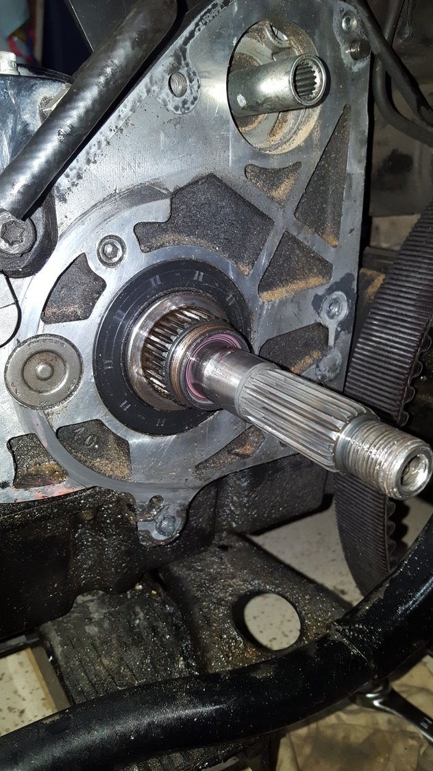

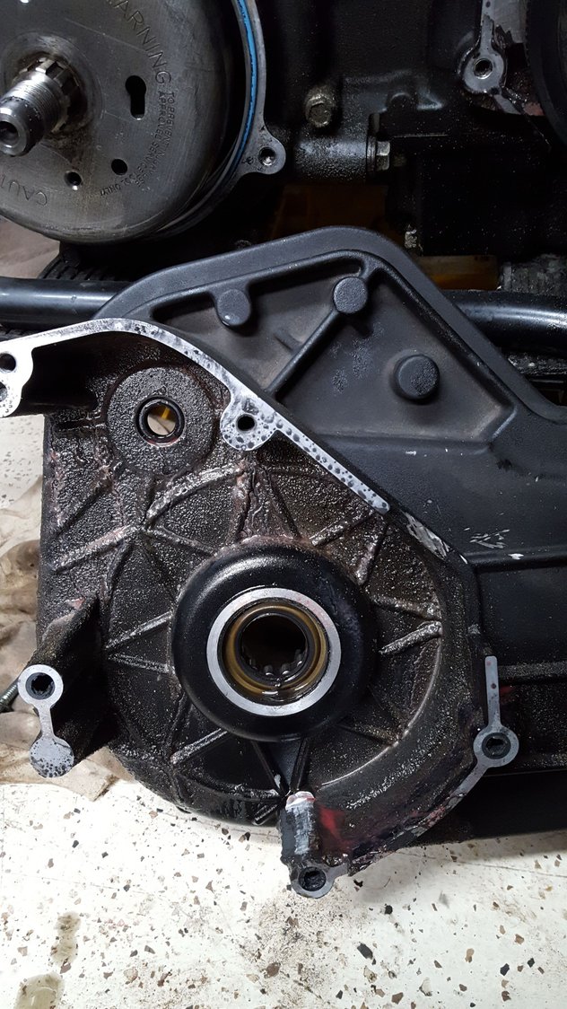

Some pics.

Received 412 Likes on 250 Posts

This maybe stupid cause I am a noob. But did you replace the o ring that goes around the shaft?
Its part number 11165 quad seal......
I don't know if it can leak there or not, but I put a new one on mine.

let's see a pic of the main gear splines...... that's the part that the pulley slips onto.

was the pulley fit tight or was there any looseness between the 2 sets of splines?
It fits really tight. It's a new pulley.
