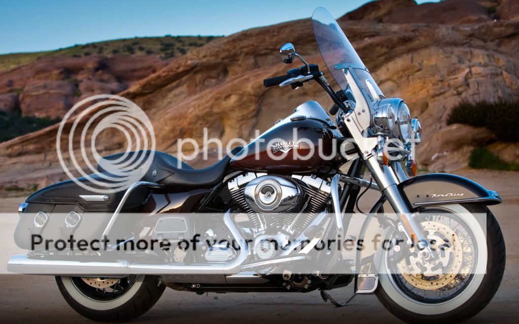

Talking Is break in period essential before exhaust upgrade?
Just pulled the trigger on a 2011 Road King Classic w/PowerPak setup, 1690 cc, 103 engine, (two-tone Candy Root Beer)
Is it necessary to do the initial break-in (500 or 1000 miles?) before upgrading the exhaust? will be going from the jugs back eliminating the cat and stock header pipes, just not sure of which system to go with yet for that classic deep throaty sound at idle & cruise, all and any suggestions appreciated,
btw...this is my first brand spankin' new bike. ... Thanks, Buck
