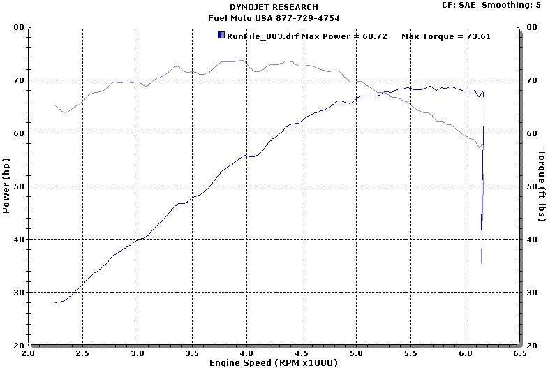

Here is the baseline test we did. The bike we used for testing is a 2005 Touring with 8000 miles, it had a set of SE slip on's, a Stage 1 air cleaner, and a Stage 1 download.
