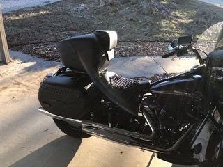

The Viking Tourpak installation was fairly easy. If you are using either of the H-D tourpak racks, the Viking hardware is way too large. I used 5/16 coarse thread with nylon locking nuts. I bought 1 1/2 in length, but I inch would have been easier.
If you are careful locating your drilled holes, you can get about 3/4 inch forward-back adjustment. I took a quick spin around the block and I believe this set up will work well for longer trips. I'll revert back to the solo luggage rack for daily fun. If I leave the tour pak on very long, I've learned that I will add "stuff" I rarely need and find myself carrying an additional forty ponds around. I downsized from touring bikes to get away from that.
There are no key blanks around here so I order a couple from Viking. The only local key grinders in a store were Home Depot and WalMart and with limited capability for single side key grinding only. All other locksmiths listed seem to be mobile and less interested in making keys from blanks than helping folks locked out of cars, etc.
