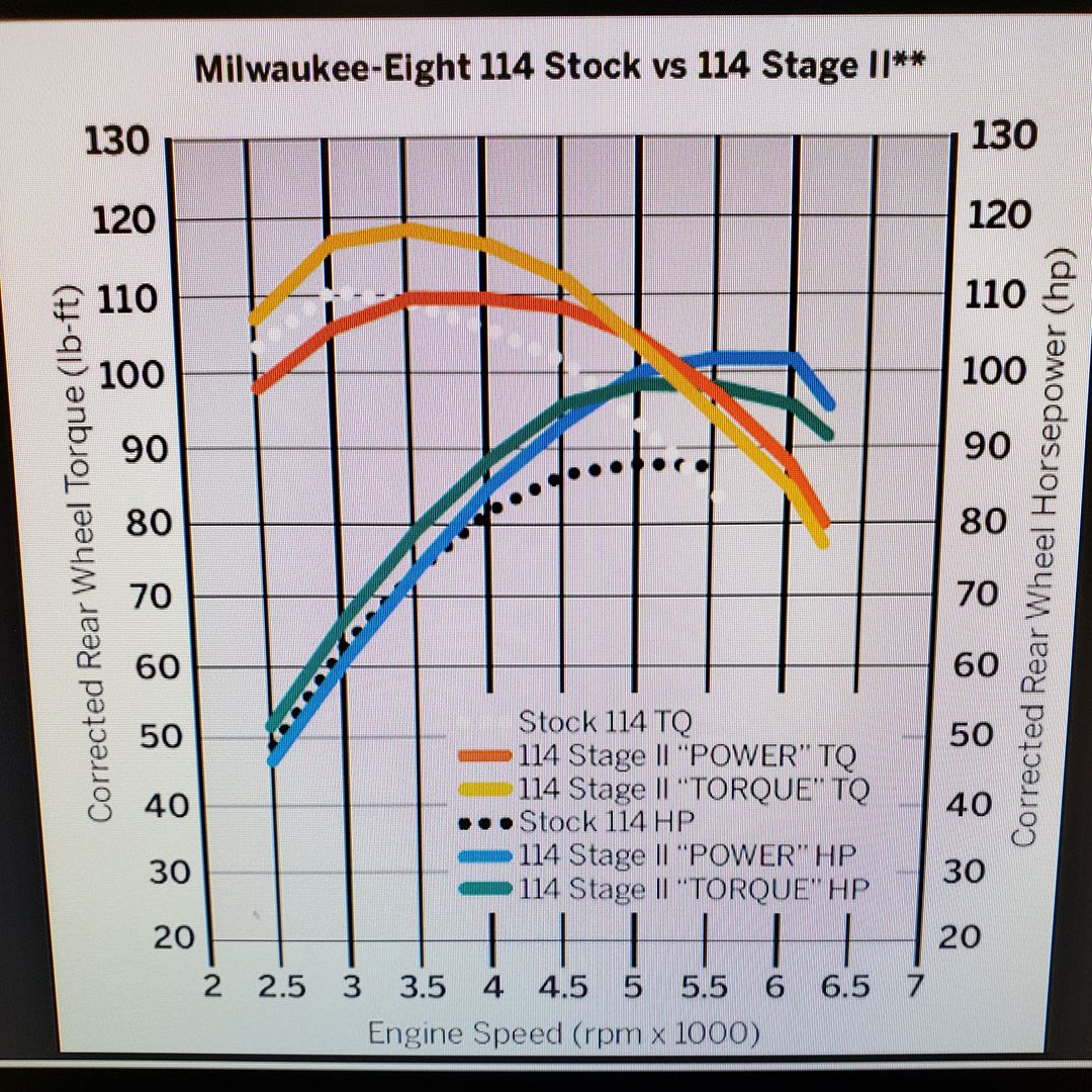

Good information here! I've been trying to decide between the Torque Cam and the HP cam. From looking at the charts in the catalog, which are labeled incorrectly, the HP cam still provides a bit more torque after about 3500 RPM over the stock cam and keeps pulling on through the higher RPM's. I hate the fact that my bike starts off super strong and then dies off at around 3500 RPM.
Hearing the real world experiences with the torque cam helps give a better Idea of what to expect. Still leaning towards the HP cam but want to hear from others that have experience with that cam before I make up my mind.
* Edit: After reviewing the updated charts online, the overall HP difference between the two cams seems pretty minimal but the difference in Torque seems pretty significant. May just have to go with the Torque Cam after all considering I would hardly ever take it over 5500 RPM. Wouldn't have much reason to when it would get up to speed so quickly with that low end grunt with the Torque cam. Now to decide and take the plunge....
