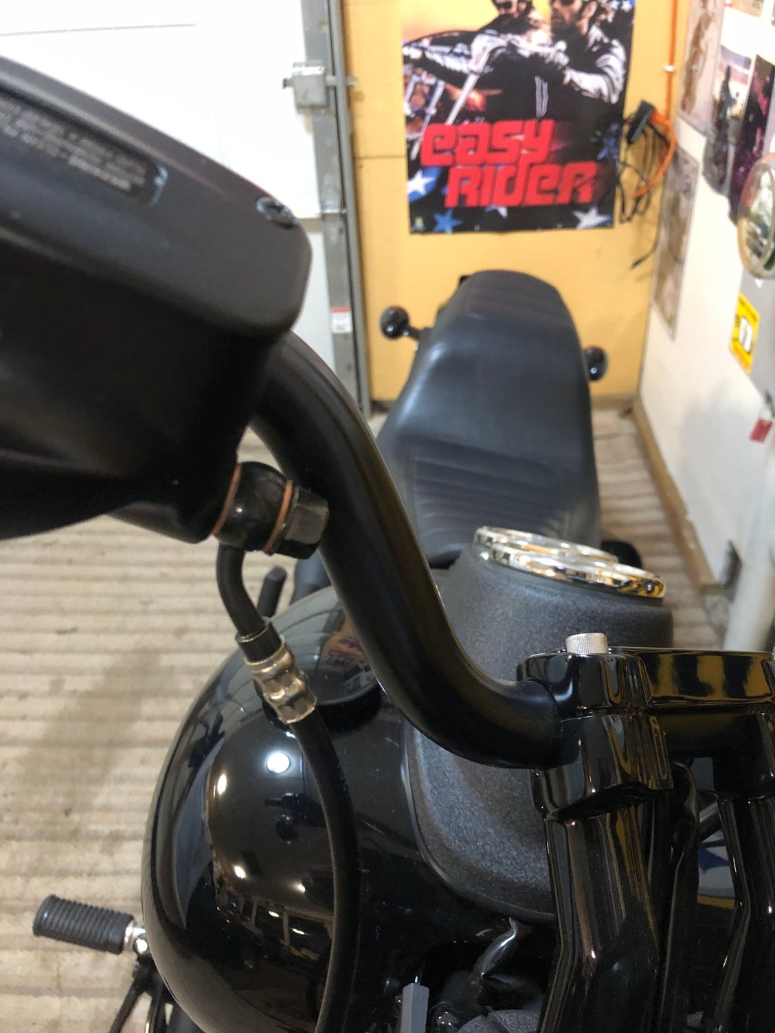

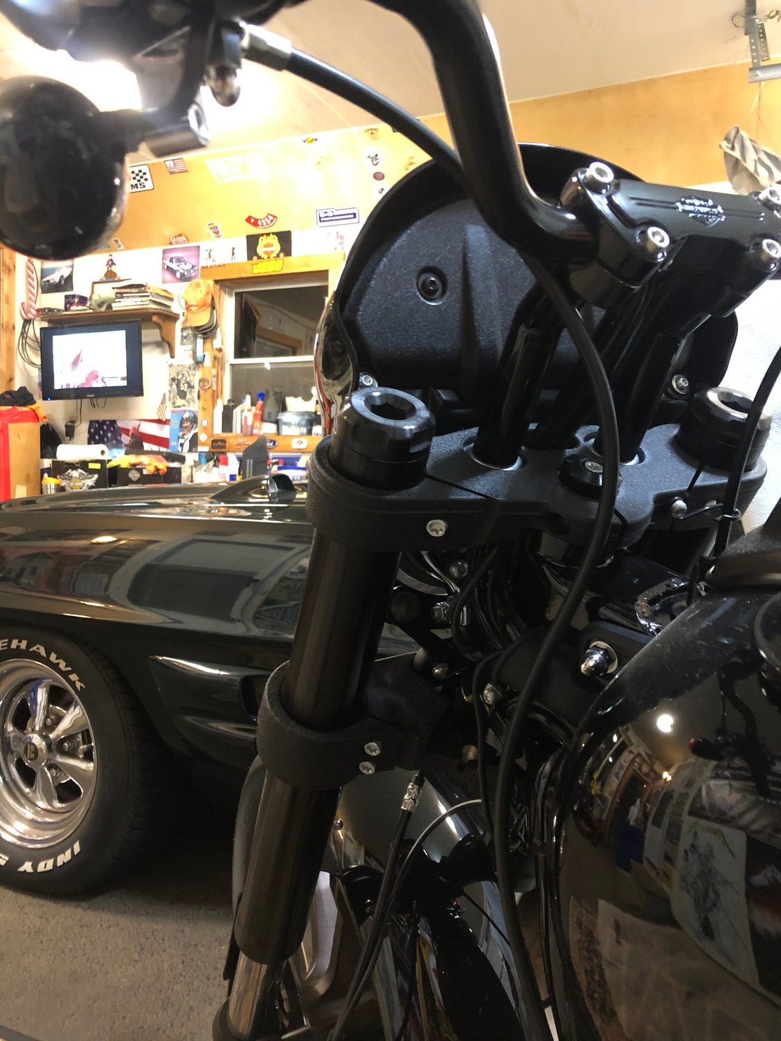

Originally Posted by Durham man
I went with drag specialties 5.5 pull backs. Big improvement in comfort. I am also 6ft tall. Congrats on your purchase!
Hi can you take a picture of your cable routing for the riser install. My brake cable don't look long enough?
Old Jan 7, 2021 | 12:25 AM
Durham man's Avatar
Durham man
Joined: Mar 2017
Posts: 3,321
Likes: 1,884
Full lock left
Old Jan 7, 2021 | 12:40 AM
Durham man's Avatar
Durham man
Joined: Mar 2017
Posts: 3,321
Likes: 1,884
I did turn the banjo fitting down for more slack. It seemed o.k with out the turn down. You should be o.k. I went 5.5 some have gone up to 6.5.
Old Jan 7, 2021 | 07:36 AM
Lanyu's Avatar
Lanyu
Joined: Dec 2020
Posts: 78
Likes: 14
From: Ocala FL
Cheers Durham Man
