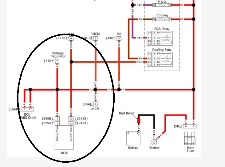

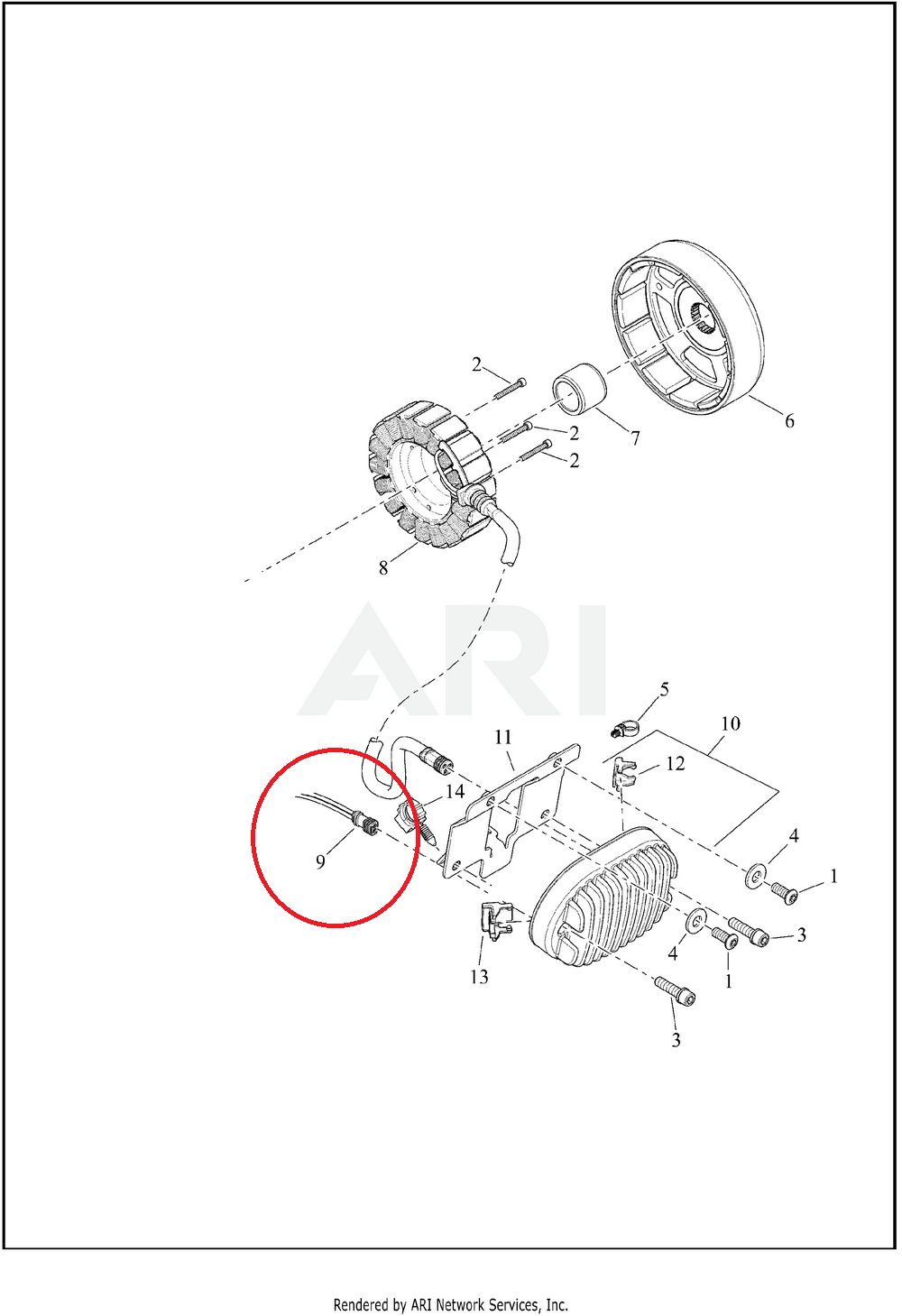

Ref: 9
69201760A
WIRE HARN SUB-CMPNT,DC LEAD ASSY | voltage regulator (from main wiring harness)
Price: $95.67
Cheaper than a Voltage Regulator.

Not sure what the sell know, but on the bike I replaced the wire for, they sold you around 18" that you had to splice in. I missed where it came into the topic.

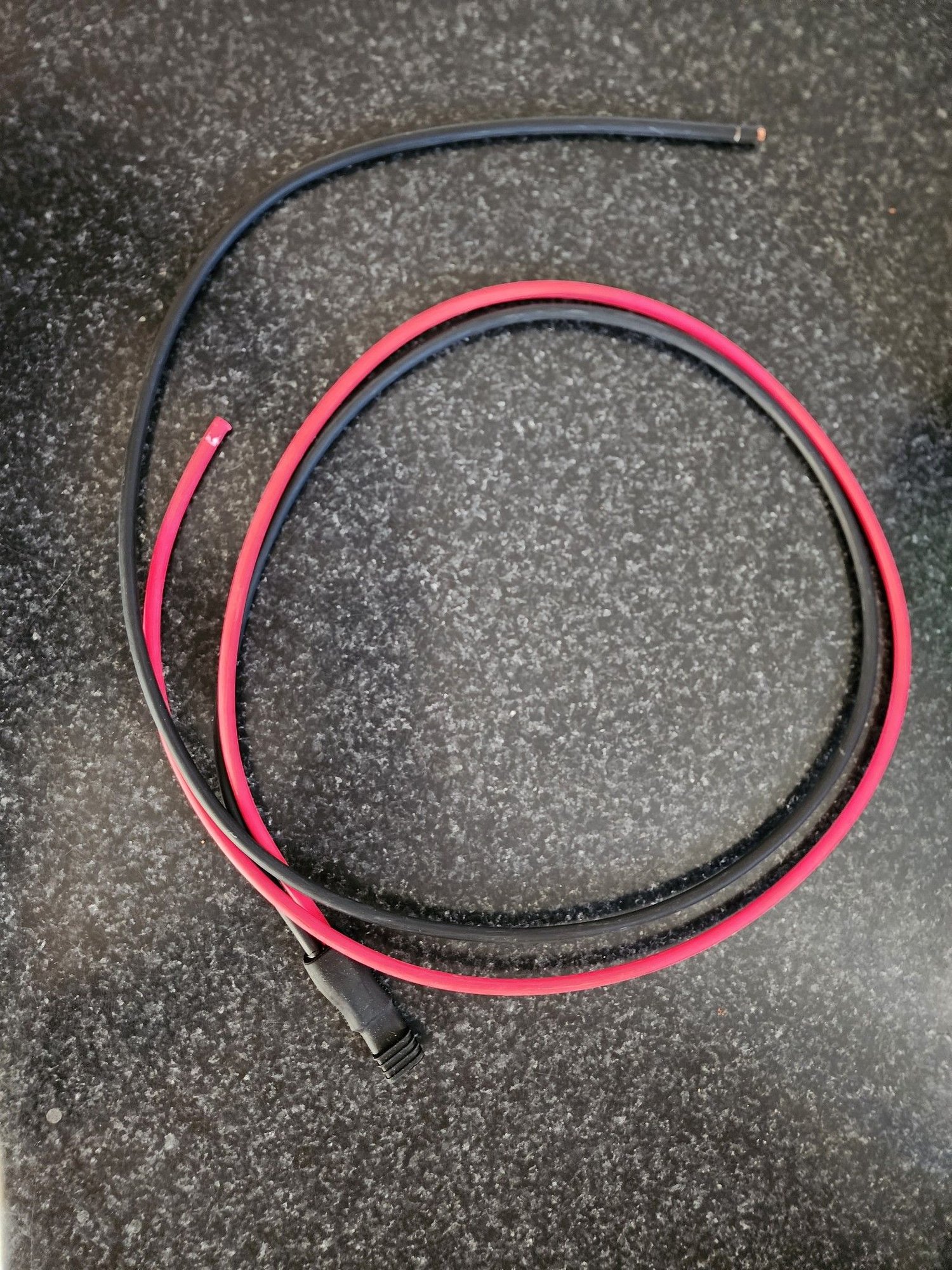

Got another harness coming in Tuesday from a buddy in Denver. Besides a crimper, do I need any other special tools? How difficult is it to connect the red end into the ECU? Hopefully I can find a YouTube video to kinda get an idea of what I’m getting myself into before I actually do it. I’ve got a 2022 service manual and a 2021 wiring diagram.

Heat Shrink & a Heat Gun.
Red goes to BCM should just be able to splice into the red wire that is already there that goes from the BCM to the Voltage Regulator. Make it easy on yourself and splice down where the regulator wires are near the voltage regulator, leaving enough slack to heat shrink and zip tie with some anti chafe tubing if there is not some there from the OEM installation.

Solder and sealing heat shrink. Do it once. Do it right.
