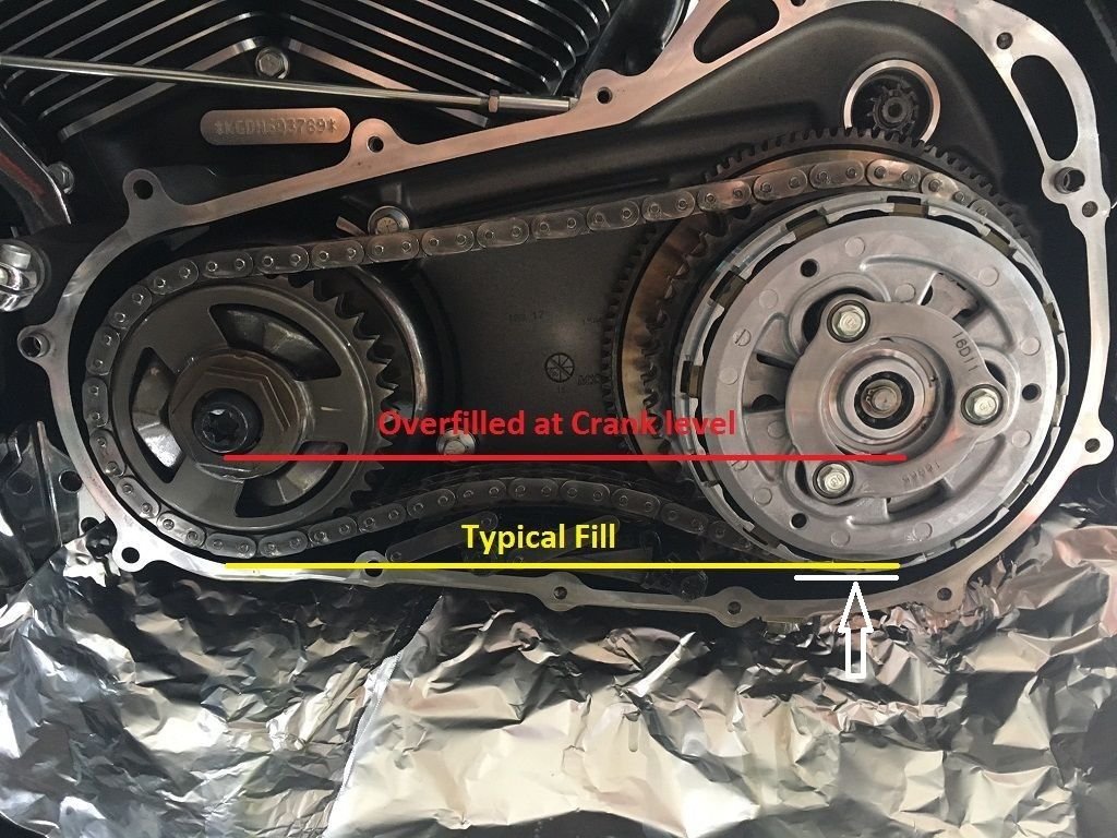

You may want to adjust the amount of fluid in the primary as too much fluid will allow the clutch plates to drag and not shift well.
