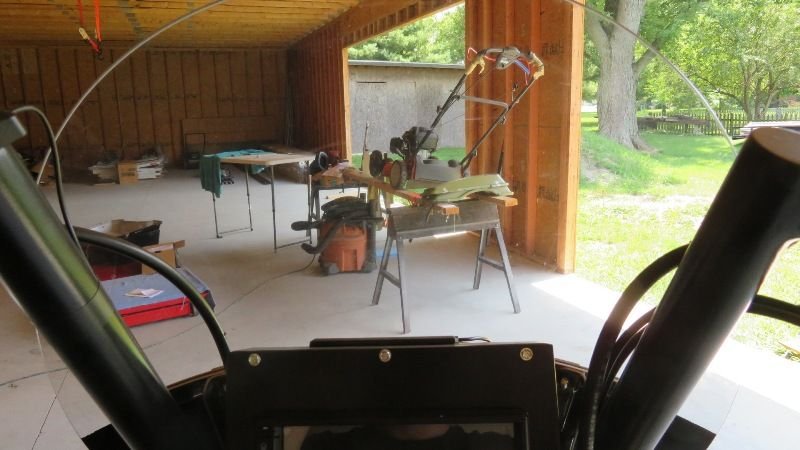

First pic is looking over the radio box. The bottom of the sawhorse is about 7 feet in front of the front tire. Ignore the crap in the back of the pic. Currently building my garage.
Screen shot of the touch screen as I see it from the seat.
Looking from in front of the bike towards the rear. Looks fairly neat, doesn't stick out nor does it cause any issue with vision. If I lean forward, I can see more of the ground in front of the tire. I haven't looked over a fairing so I don't know how much of the road one can see looking over one.
