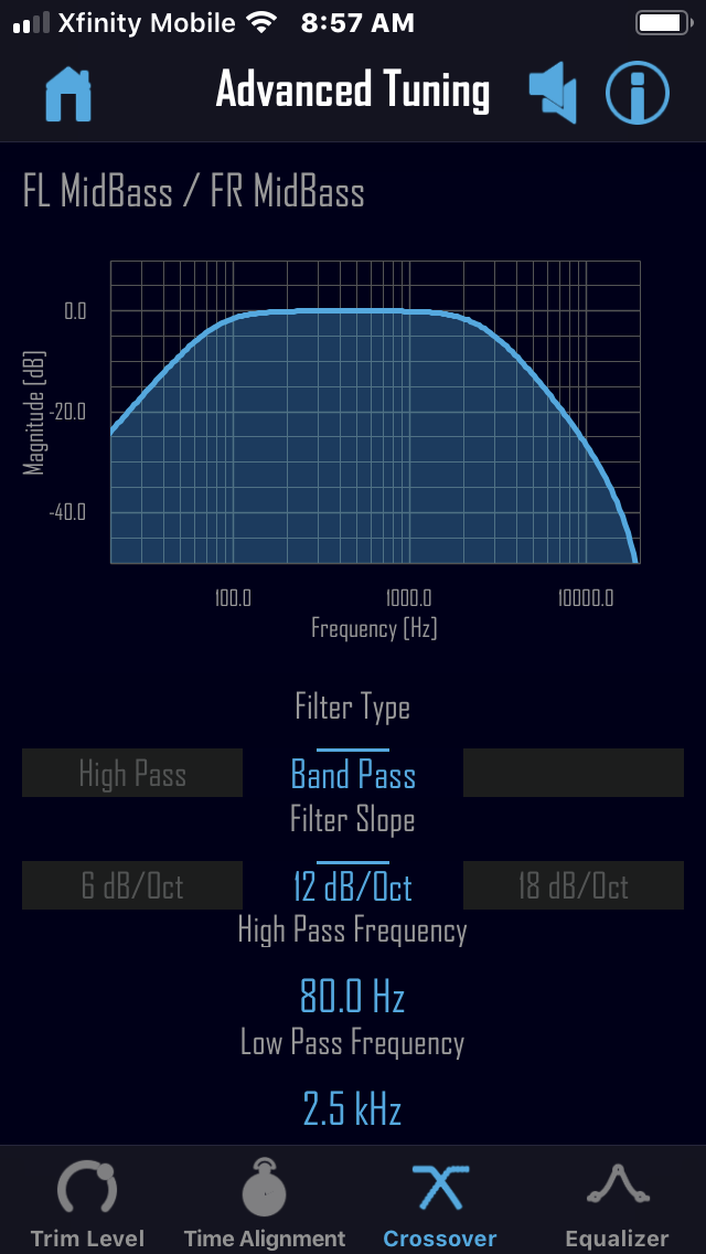

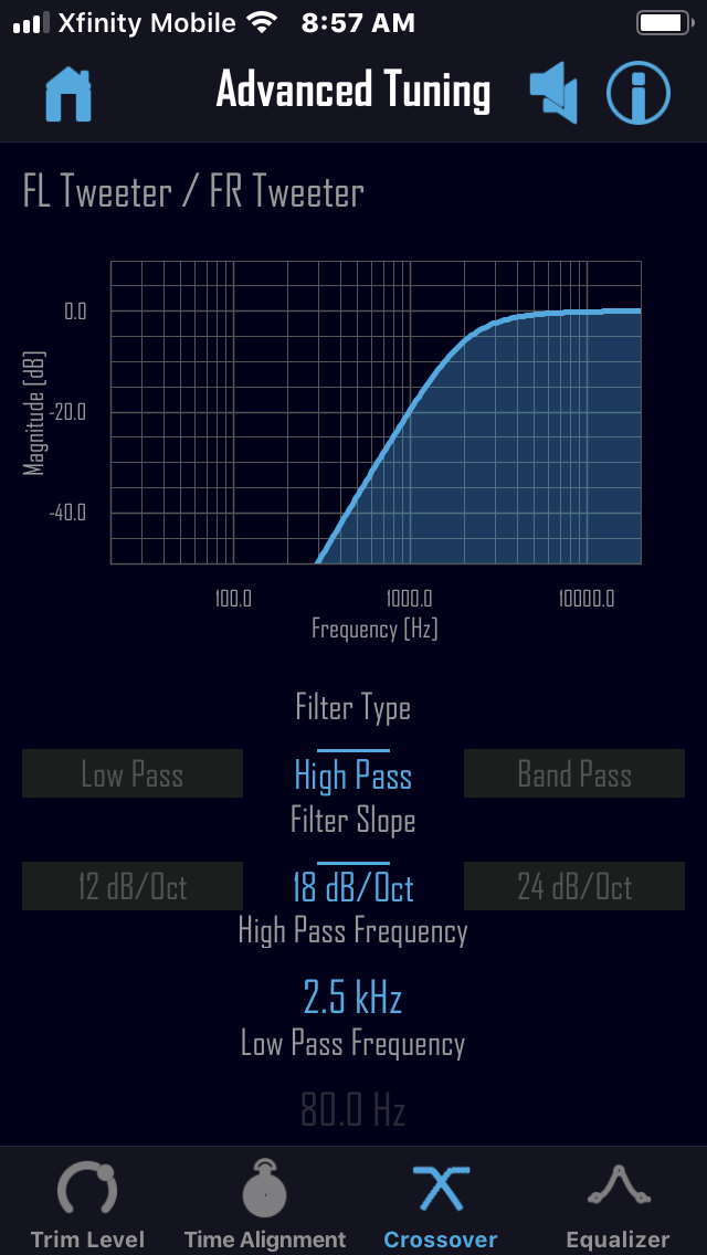

Originally Posted by Tailwind View Post
That's what's so damn strange here as the stand alone "Pro" woofer is damn near identical engineering and also is proven to be a solid play in the same location.
This has to be sumfin out of the ordinary and not an actual make model bust.
Tuning strategy maybe? Wiring?
Maybe the OP can share some tuning info?
T
So here are the crossover points on the DSR1
