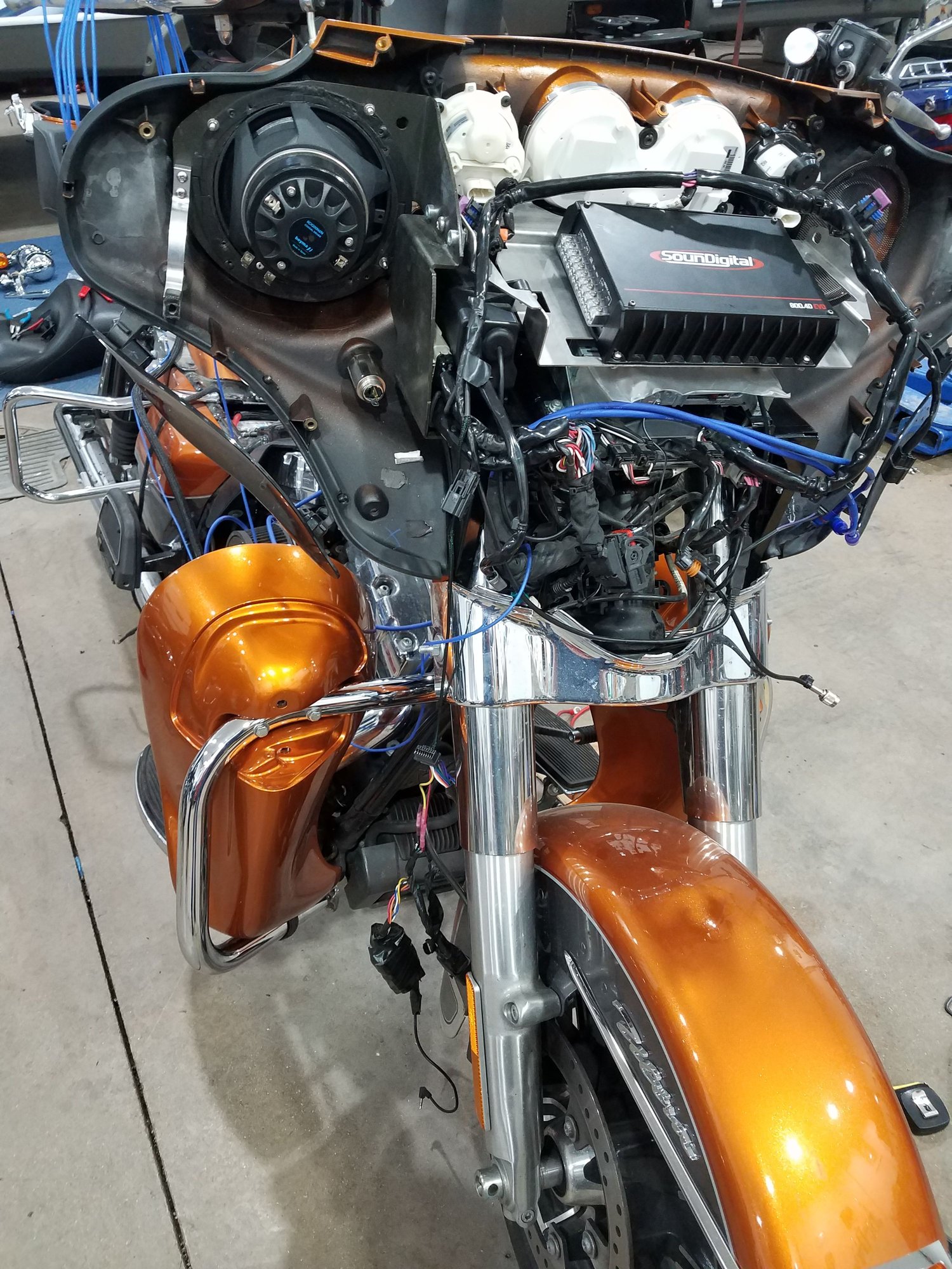

Try these

Yes they are the BT brackets, you have to open up the inside diameter a little and mount them from the front.
I have not hooked them up, But alot of the big shops are running them with the back of the pods completely open. That many people cant be wrong. I would cut the back of the pod out or go with the BT brackets. They will not be completely open once you button the fairing together. These speakers are rated to play lower than the 100hz you have them set at. How low you want to go may depend on the amount of power you feed them.
