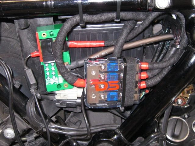

I bought my system from Carlos at NVS , I added the frame ground he show's in the video , he sent a distribution block with my system thats fused for both amps and an aux power for any accessories I want to run. The green block I added to run any accessories off the aux power wire and ground I added from the new frame ground.

That looks nice Stopit. Unfortunately a lot of us have a big old ABS hydraulic unit where all that stuff is.

This is from last spring actually , I know there a pretty busy shop these days , I called them when I ordered mine , had to ship my freshly acquired GTS to them and have it unlocked , flashed , and Apple Car Play / Android Auto activated. There's plenty of punch in this system for sure.
