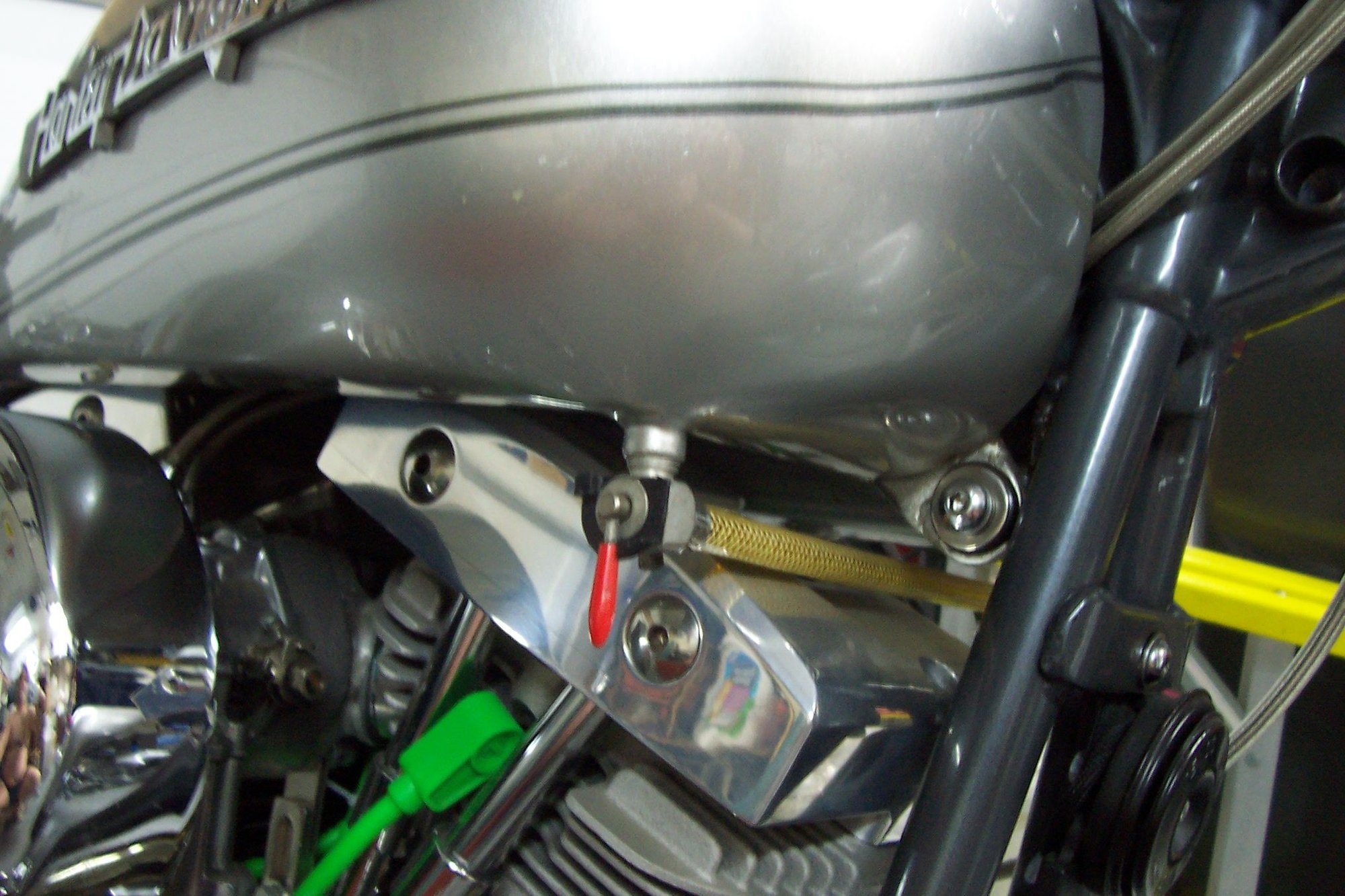

What needs to be done differently is add a second petcock, there's no hose from side to side that I can see. That or have one on the left and add the connection hose tank to tank.
Did this to the current flat side rubber mount tanks I run on the shovel. Did the cross over with valves to make pulling one easier or could be used as petcock in an emergency.

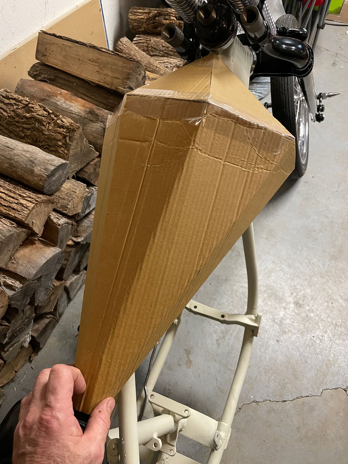

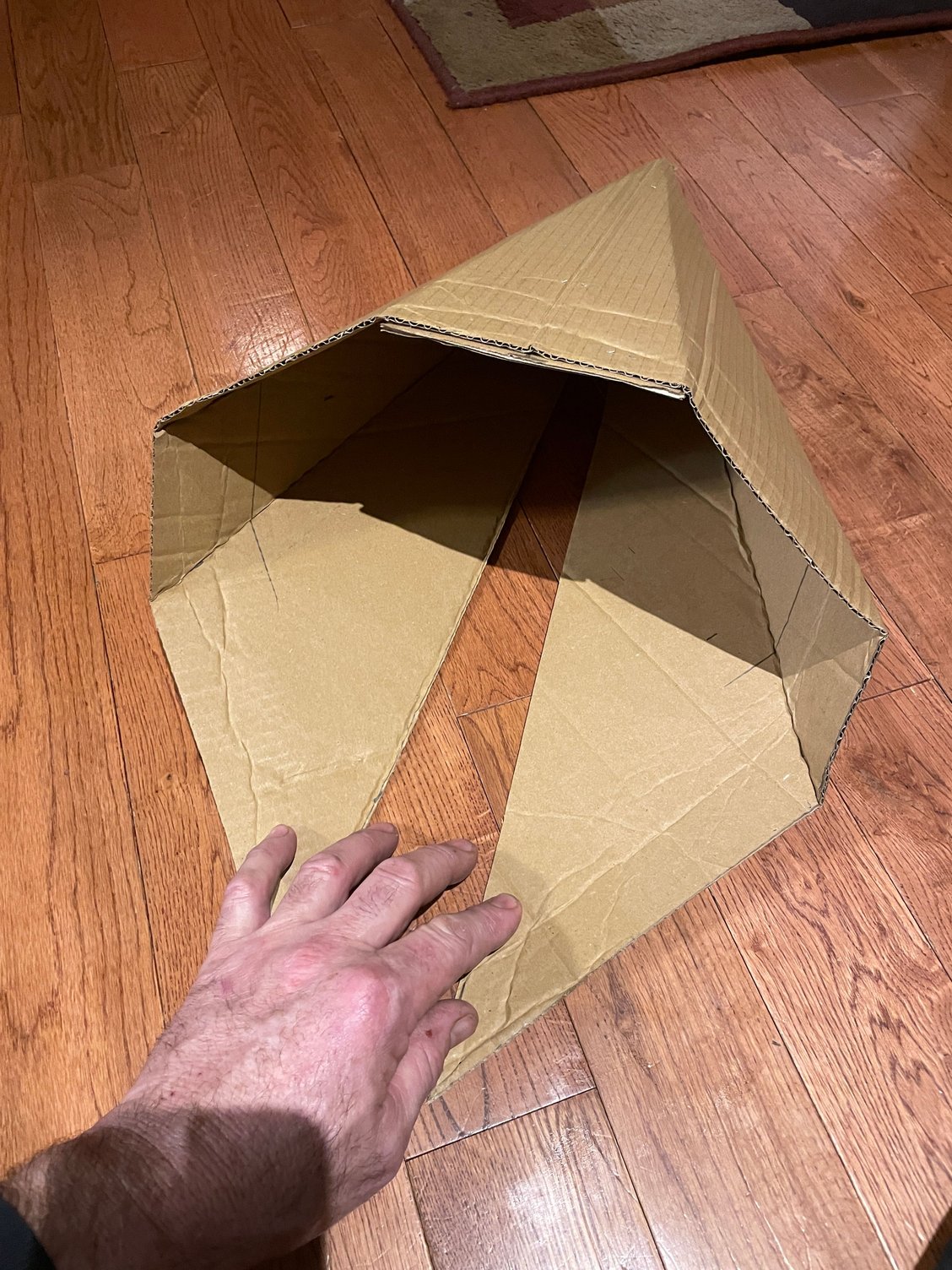

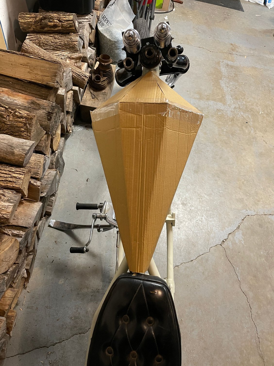

Started on the tank tonight. I might have to shrink it a bit length-wise and I need to figure out how I want to mount it. Something fancy from underneath that you cant easily see but a royal pain to make work or a tongue out of each end with a bolt into the frame. That'll determine tank length as well. I like how it looks on the bike though.

Enough coats of epoxy and that'll work like a charm!
