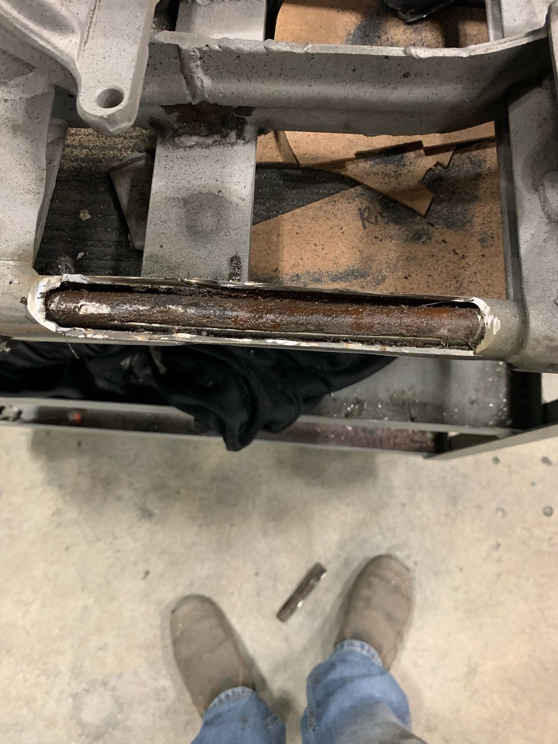

Dont have to slug the lower tubes, after cleaning out the garbage it turns out there's a 5/8" solid bar almost the full length of the frame on both sides. It's welded at the bottom but we're going to stitch weld it inside before closing it up. Im going to weigh the frame and compare it to a stock one I have here just out of curiosity.

What was all that crud and corruption inside the frame rail?

Grease and sand as far as I can tell, at least it wouldn't rust.

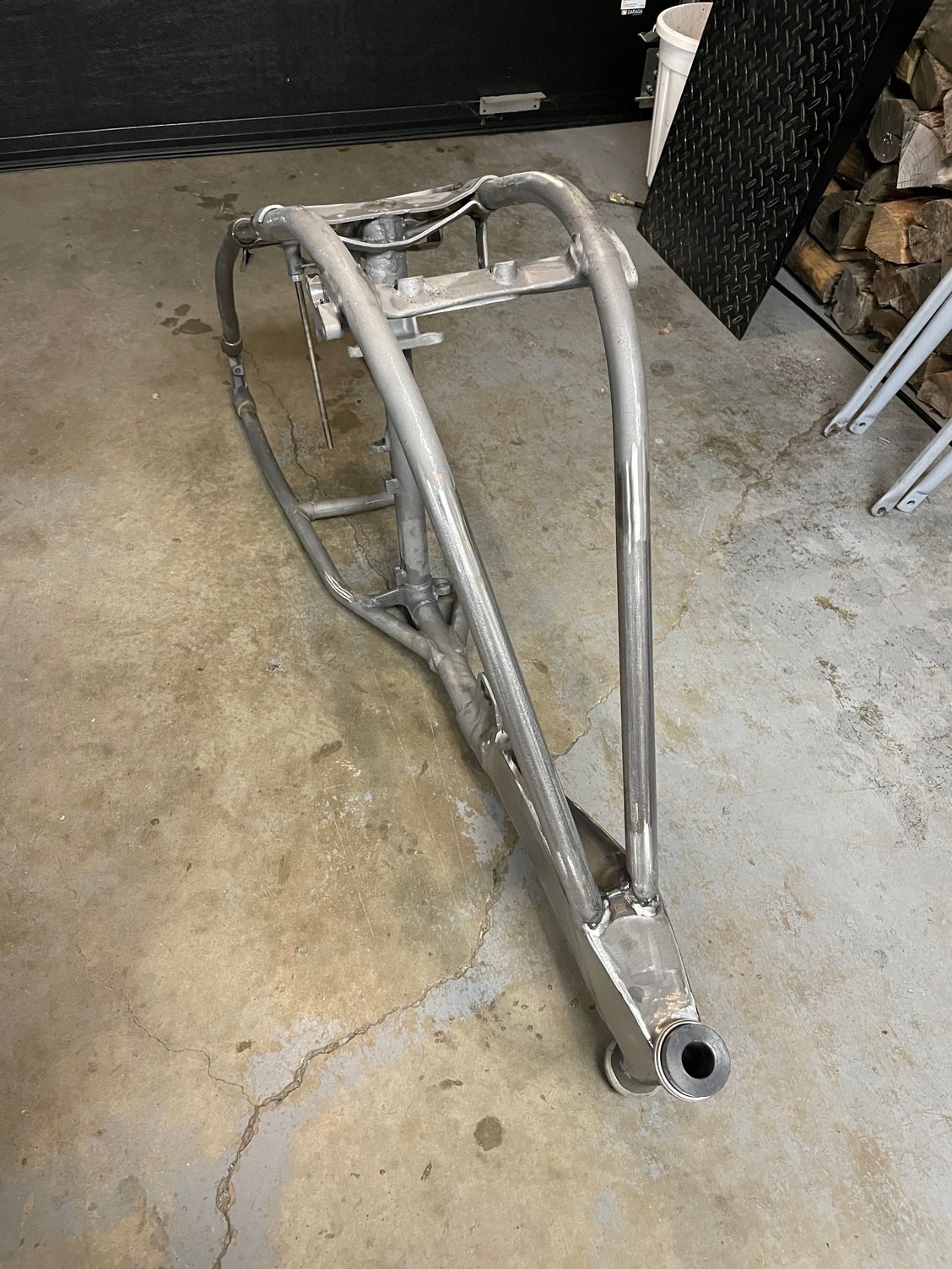

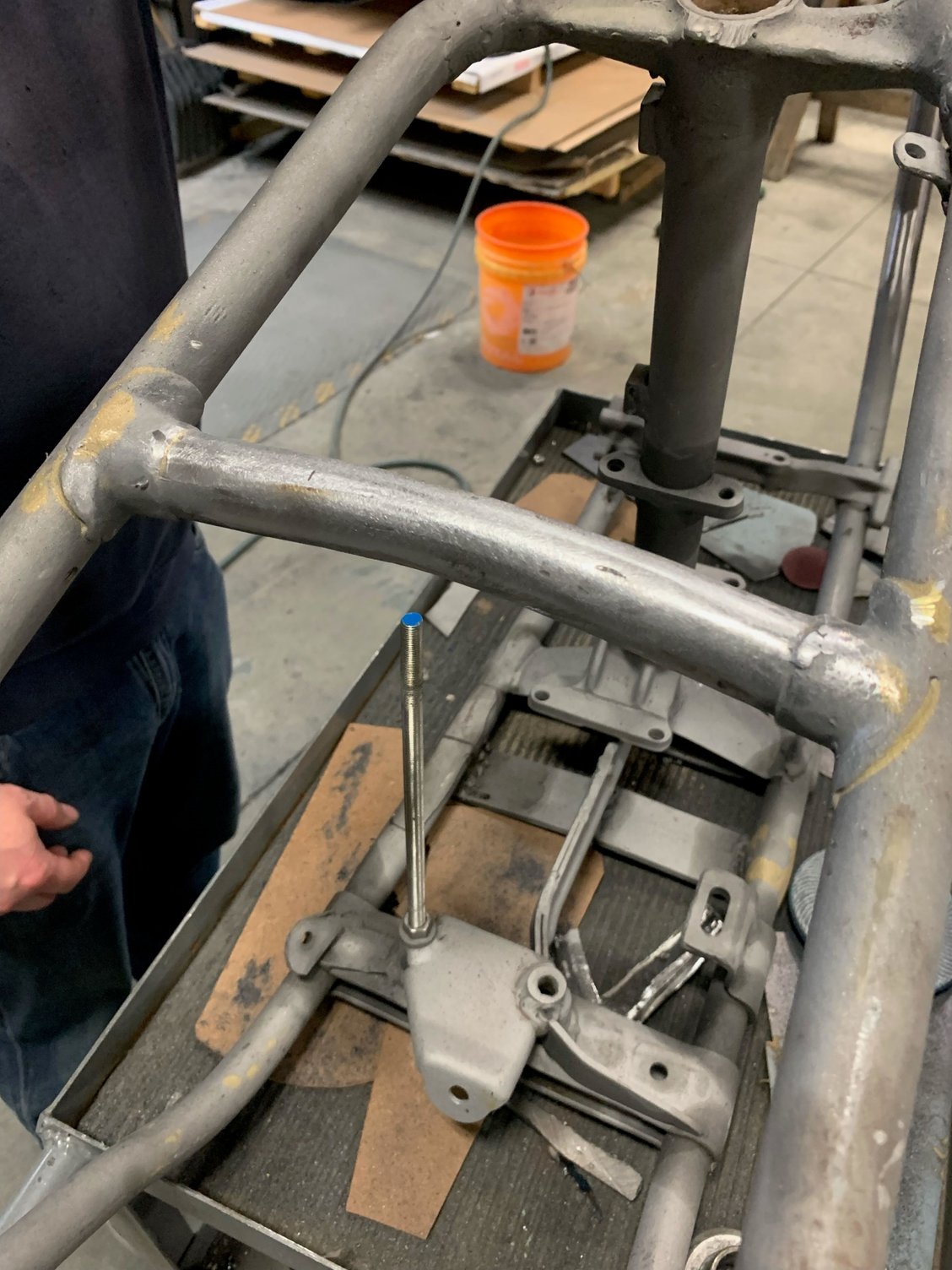

Since these pictures Ive epoxy primed the frame to seal it. One to stop the rust and the secondly to create a sandwich of sealer for the filler so its not contacting bare metal. Bondo on bare steel was the thing to do but not these days. So the epoxy buys me time preventing rust while I mock up the bike with the new front end to see how level the frame is.
The backbone will be left alone (yes it looks bad) until I figure out the tank setup then I'll weld and grind as required.
I'm thinking of stealing Dan's idea by making twin tanks from two prisms that get cut down a bit with a small gap or I can figure out something different to take advantage of the gap.

On the twin tanks, do the two halves then form fit a piece in the top welded & blended to make it like a bug single from the top down. Would allow you to do a custom iso fit up and hide the front the mounts. That was my original plan but I didn't have the tools or access to make it happen at the time. Used a lot of brazing rod on the tanks I did as it was.
