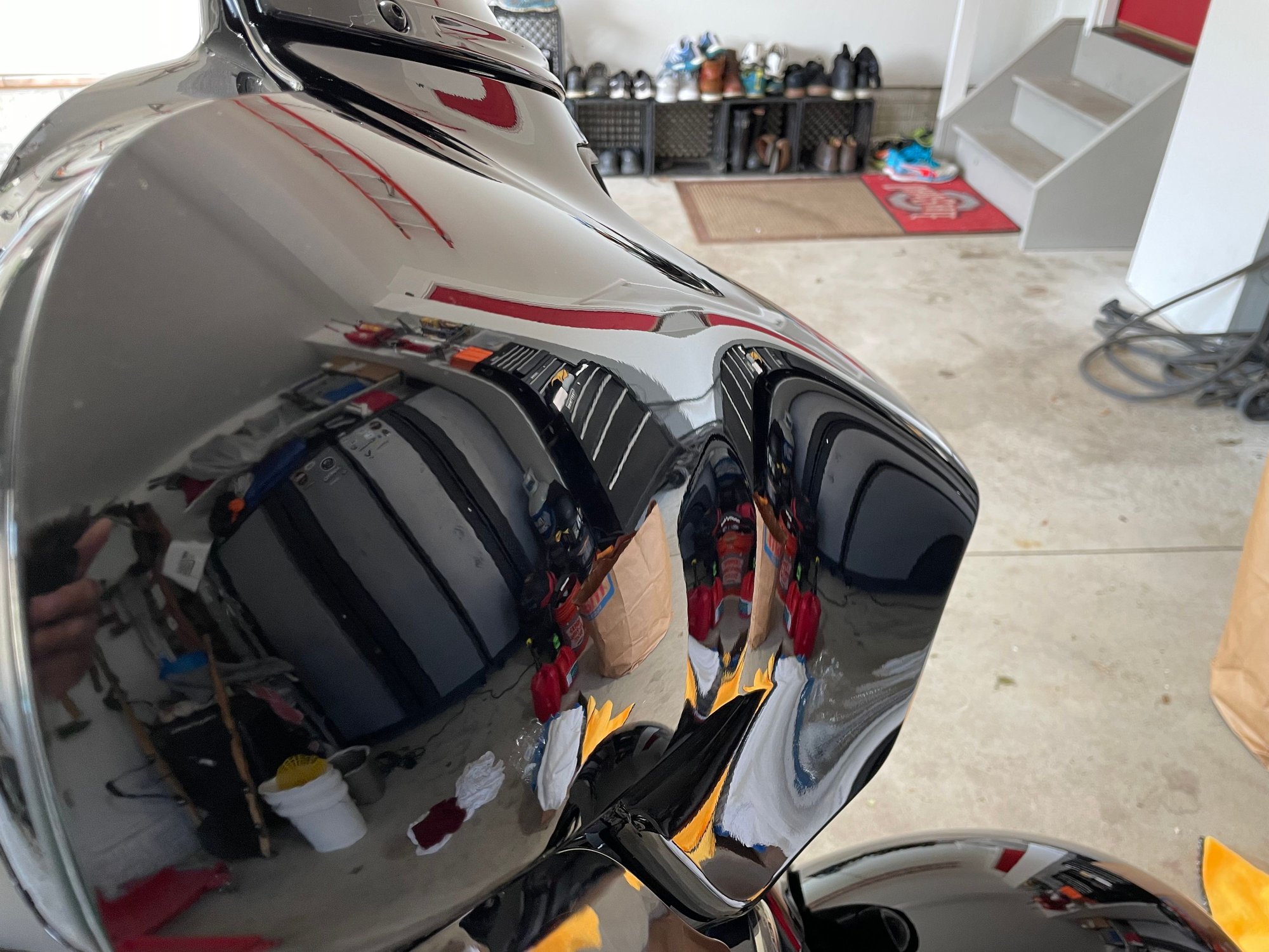

I just did my bike over the weekend. I used AvalonKing brand. The coating part was piece of cake. It was the prep that took a while. The paint should be as perfect as possible before coating. First, I washed the whole bike using their prep shampoo. Once washed, I used clay bar to remove anything from the paint. I followed polishing every part with yellow pad for not so bad areas and orange for ones that needed little more TLC. Once polished and all swirls and scratches were removed, I finished it by removing any wax with IPA spray. Some parts I had to repeat the process of polishing until the surface was as clear as possible. Once satisfied, I started to clear coat. I put two coats about 2 hours apart.
What brand of pads did you use? LC pads yellow is more aggressive then orange is why I am asking.
Di you do the baggie test before claying? Ive done a ton of bikes and only a few had spots that needed claying, never the whole bike.
The reason for the prep wipe down is to remove polishing oils, any wax would have been removed by polishing
