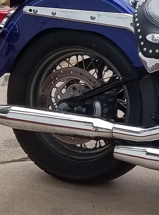

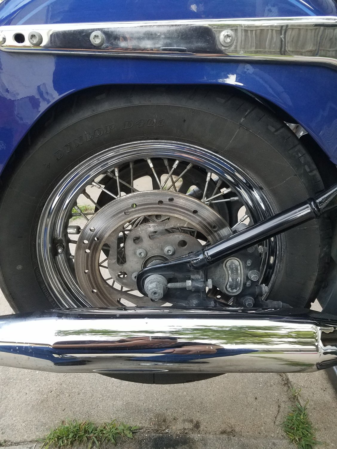

These wheels weren't pitted and are steel. I used aluminum foil and water only.
