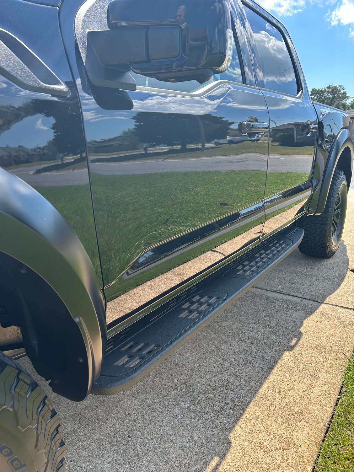

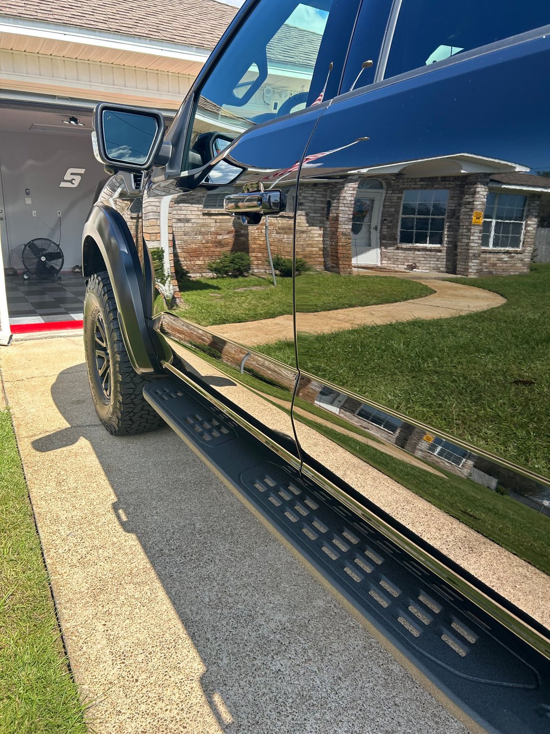

2025 Raptor. 250 miles. Paint was in good shape but the dealer installed wax muted the paint and clarity was not there
High pH soap,low pH soap, was foamed on to dwell. Washed with neutral pH, iron remover ver then decontamination towel
Paint was polished with gold standard and their pad. Spot corrected with blueberry pad
Paint, wheels and glass were coated with Clean 8 year coating

I'm STILL amazed.

Looks great.

harley???

the Road Glide is in the garage on the right hand side

Nice work man. The results speak for themselves!

Can I come visit to get a master class from you? Looks amazing
