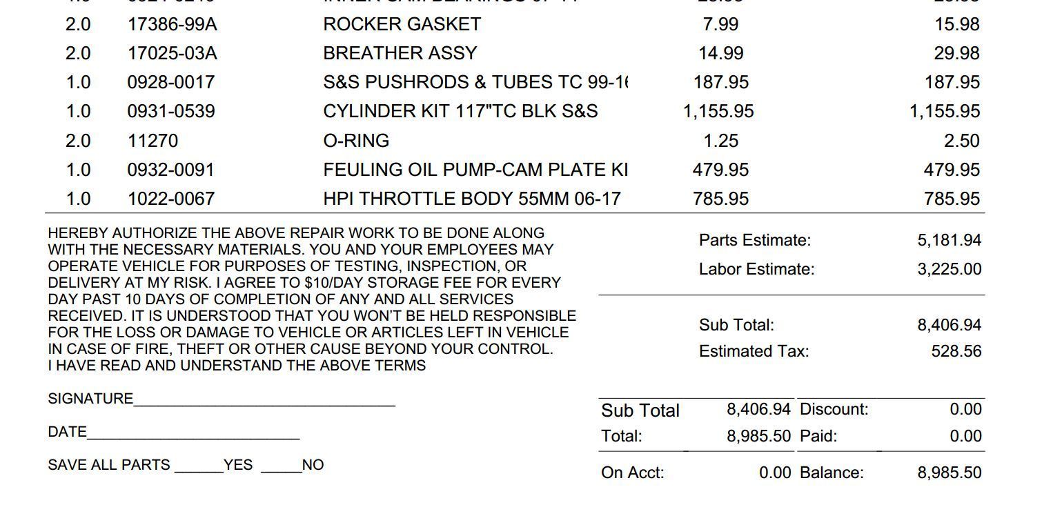

2 weeks in - called the motor guy - no joy
Damnit
Ghost
Week 3
Motor tore down, issues found (PO attempt to upgrade)
Andrews 57H cams installed - but w/ stock compression - was over cam'd
Valve seats honed - valves not lapped - losing compression
Heads ported - but poorly smoothed - shitty flow
Pushrods - material stripping off and embedded into the rockers - know issue w/ stock push rods
Many claim to be able to work on / upgrade a motor - much lessor group really know their ****
Out w/ the old - in w/ the new
Cases sent out for machining
Ghost

Damn. So your budget just went out the window. Are the heads salvageable? How big you going?
Budget was always a complete rework (9K or thereabouts)
It'll be a true 117 (bottom to top) - bullet proofed (w/ the good stuff)
eta - all the crappy work done..., does explain the performance it was missing
Ghost
Ghost
Nice! What's the bore & stroke for a true 117?
  #9067
Old 03-17-2018, 05:57 PM
Ghost_13's Avatar
Ghost_13
Ghost_13 is offline
Join Date: Jul 2016
Location: Texas
Posts: 4,364
Received 6,926 Likes on 2,898 Posts
4 1/8 bore X 4 3/8 stroke

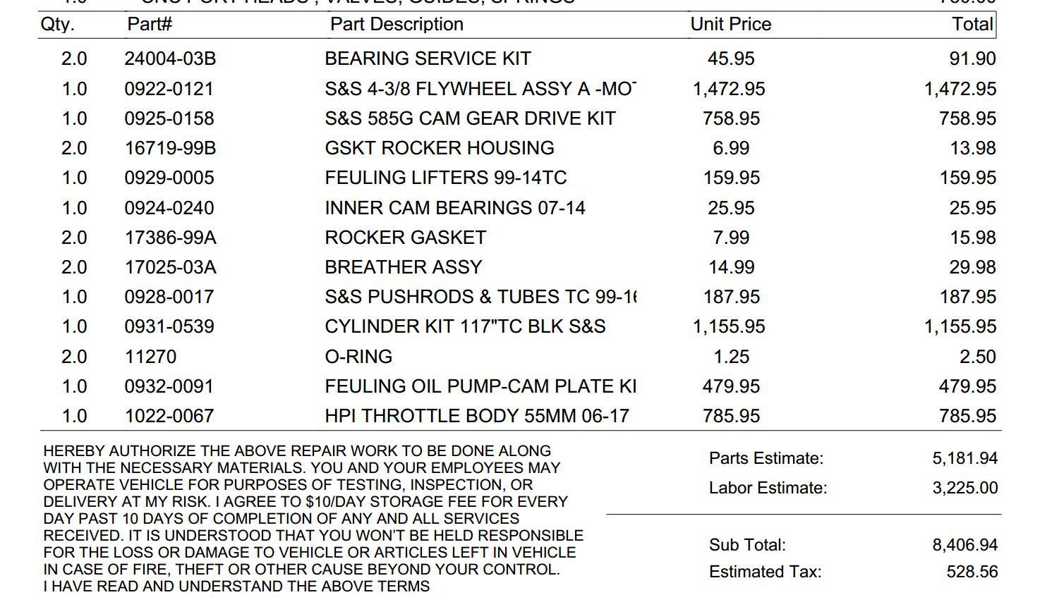

Here's the quote (too large for 1 image)
eta - Throttle body is a misprint - actually 58 MM
Ghost
