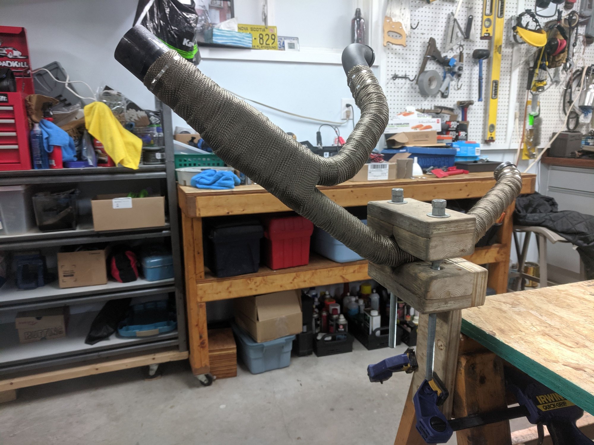

Here's what I did that lead up to this. I had the exhaust off because the powder-coating on it is failing and I was going to deal with that. While it was off I took the opportunity to do a big detail and degreasing job on the motor. To keep out water I plugged the breather holes with normal bolts, but forgot they were in there when I was done. I started the bike and noticed the rattle immediately and then 30 seconds later realized the plugs were still in. There was a bit of air pressure in the front head that hissed when I removed the bolt. I reinstalled the AC back-plate and the breather bolts, and started the bike. Same noise, no change.
