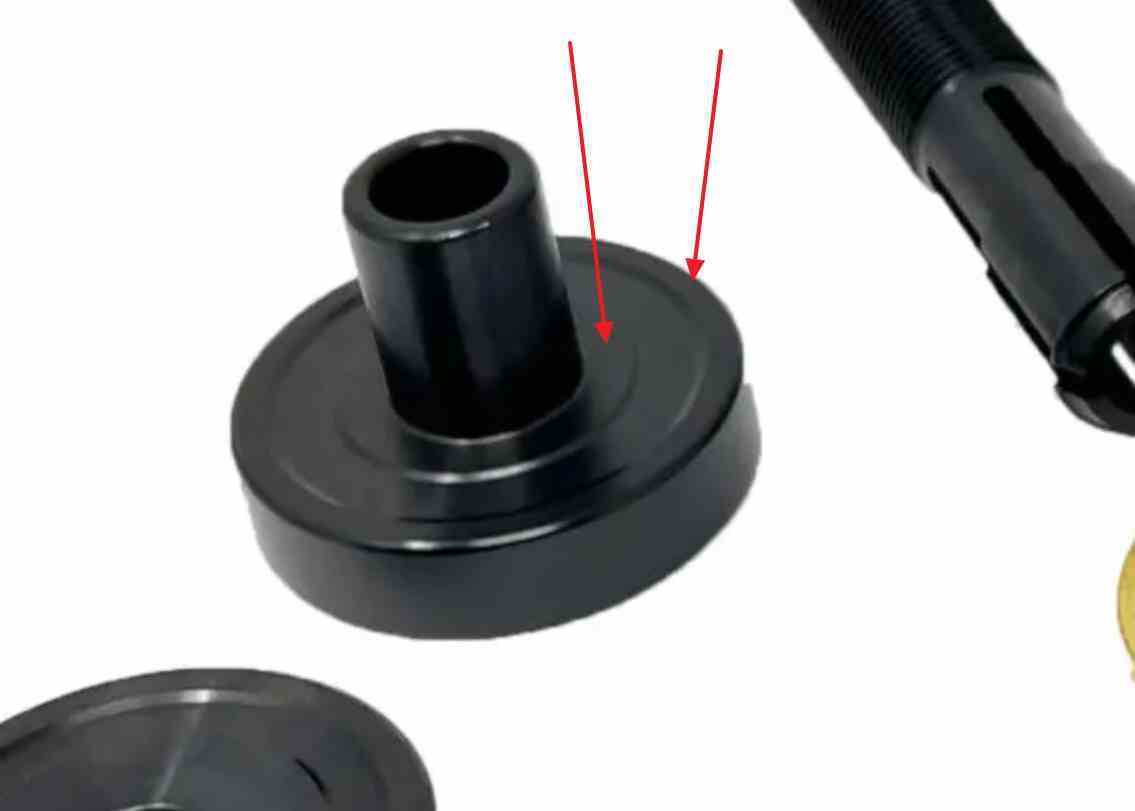

I use SKF and Nachi bearings. Timken is fine also.. It will be a standard 6204-2rs 6205-2rs c3 bearing.
The current George's tool looks good. It has the inner ridge to ensure an even press in on the second bearing. Some of the pictures of Jims tools have issues.
The part that moves the bearing in needs to look like this..
If it only has the outer ridge, bearing will die. Flat is OK..
For instance this one can cause you to eat bearings.
https://www.ebay.com/itm/391692879695
