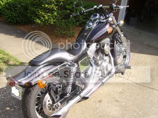

Here is a pic of a 1999 FXD that I put Wide Glide tins on. I used a FXDWG speedo but J&P sells an adapter that allows you to use the smaller FXD speedo in the Wide Glide dash if you want to go that way. Pretty simple changeover. I found that the FXDWG tanks are easier to find.
