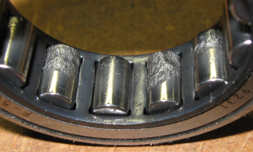

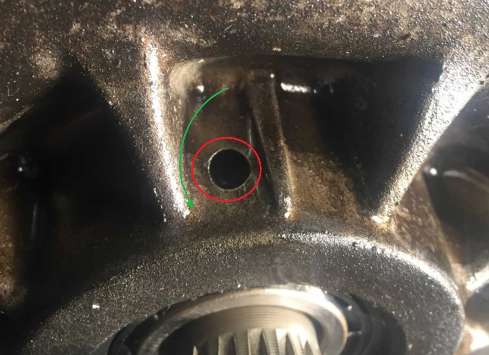

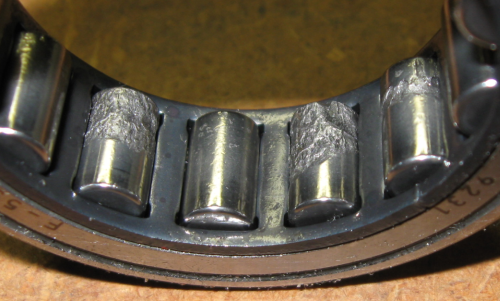

Other problem, some of the 2006 primary cases did not come with the IPB oil slung weep hole to begin with to allow fluid to the back side of bearing, to help push the old fluid out and back into the clutch side of the bearing.
https://i.ebayimg.com/images/g/gT0AA...YX/s-l1600.jpg
So on a bearing like this that the input shaft sleeve just galled the hell out of the rollers on one end.
will bank that trashed side of the rollers was the trans back side, and only the front of bearing was getting fluid to at least keep that side of rollers lubed with cleaner fluid.
