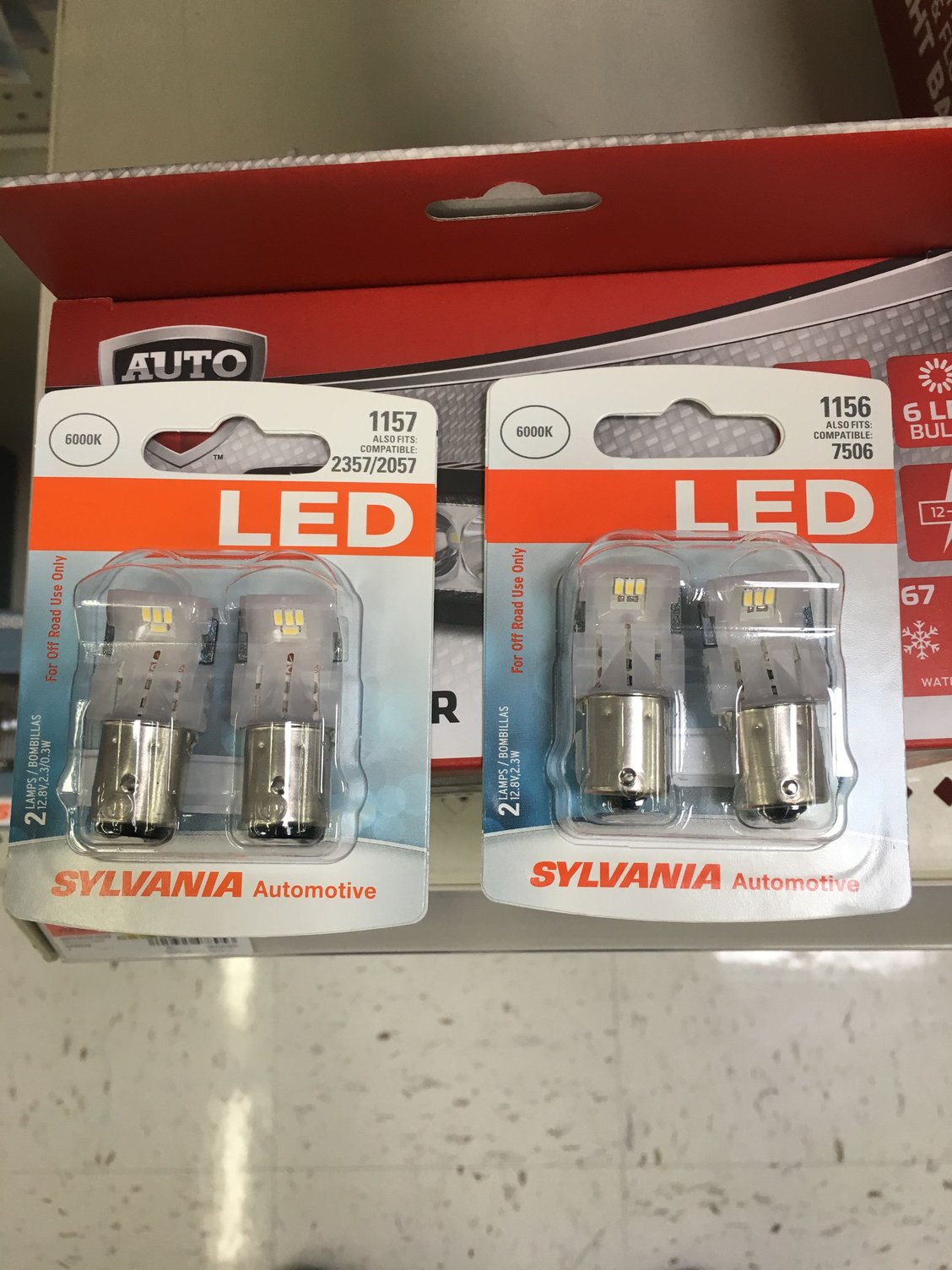

Saw these today at Walmart

Take care with LED replacement bulbs, as many of them are much larger than the bulbs they claim to replace. Visiting Walmart with each of your bulbs in your hand is a darned good idea!
I would love led H3 bulbs for my H-D oval fogs, but haven't found any yet - everything is much bigger than a stock H3. This is a typical problem:
