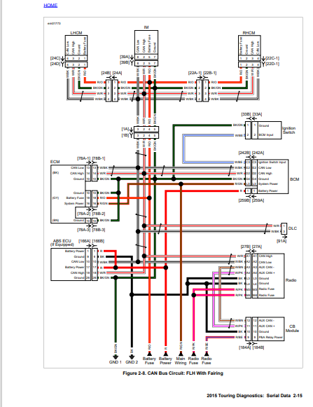

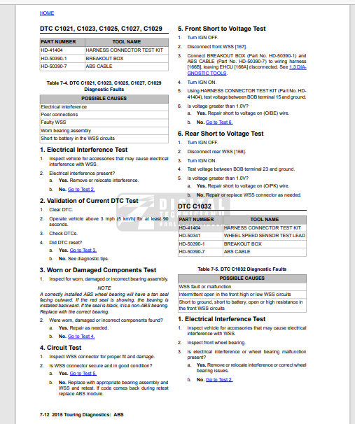

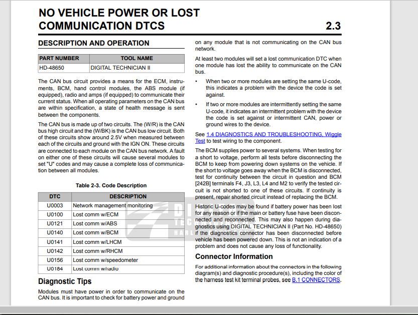

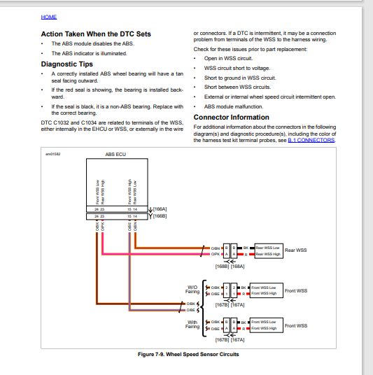

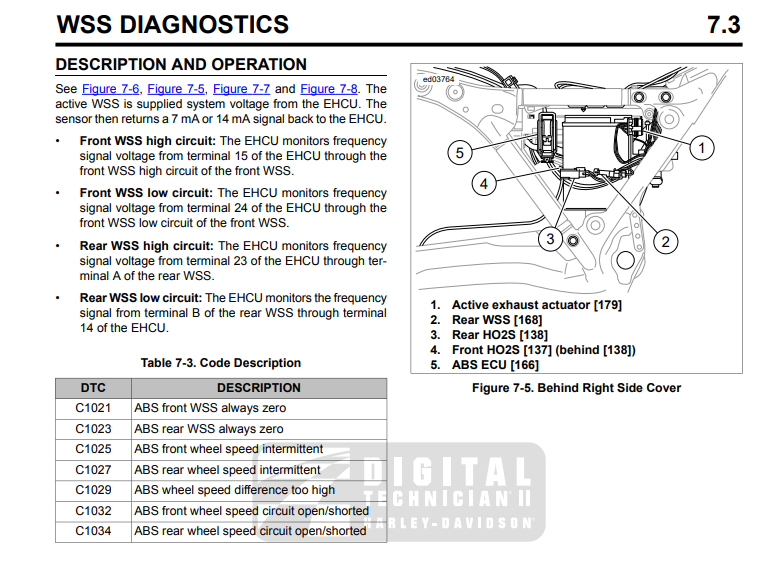

Here's a few pages from the Manual. Lost comm DTC has a higher priority than the WSS dtc.

Originally Posted by onaride63
thank you. Not sure it will help much. It looks like I need some diagnostic connecters and other things I don't have
@onaride63
If you look at the schematic and read the test you can figure out which wires they mean. Look at test 1 and 2 for ABS all your doing is looking for power on wires 17 and 1 to ground.
Test 3 is just verifying the CAN Buss wire isn't broken so your checking continuity between it and the Data Link Connector.
You can do all this with out the interface.
