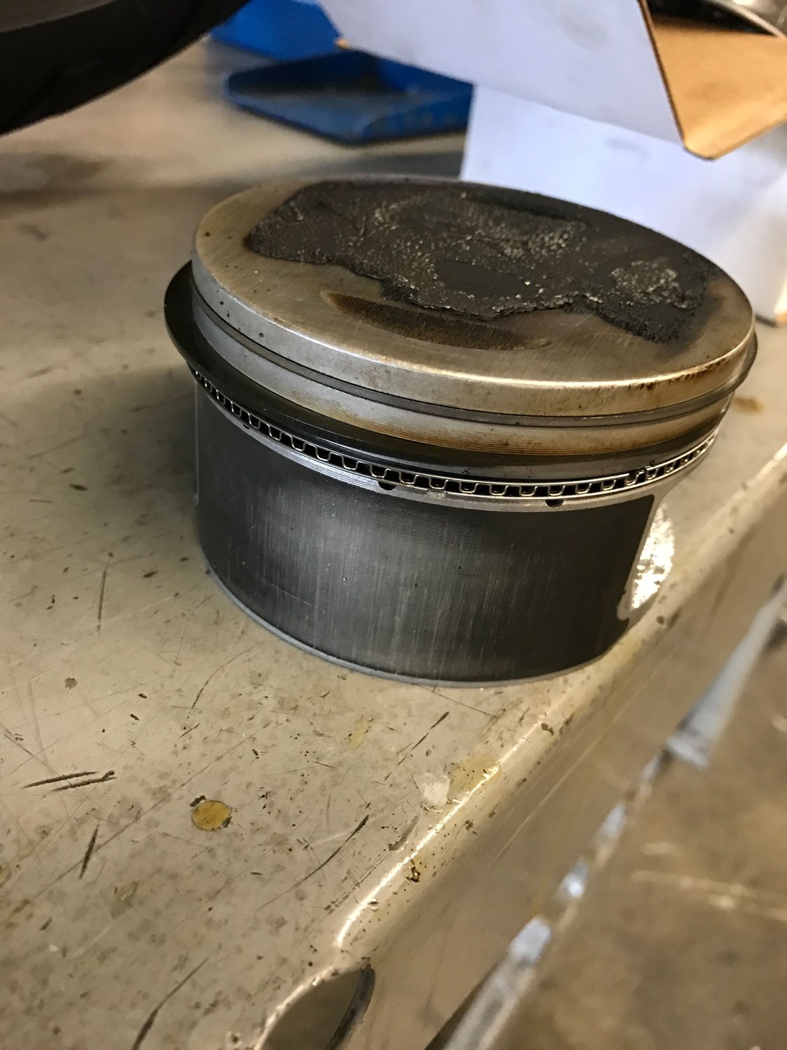

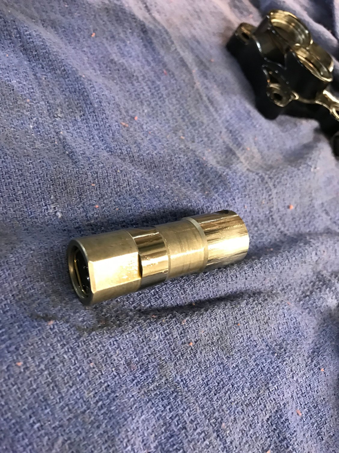

I've attached a couple photos of the lifters and also one of a piston. I don't think he checked the run out because he didn't remove the cam cover.
The bike has 510 gear cams from the previous owner which performed well with the stock 88". I decided to get a new 95" top end for a winter upgrade. I know to run gear cams the run out cannot be more than .003 or something like that. would that have changed? I've never removed the cam plate from the bike.
The new 95" top end I have is a kit with portered heads and flat top pistons. I wanted to throw this on the bike to get a little more power out of it. I originally had asked the shop to gap the rings and set on the pistons with placing them inside the barrels. Dropped the bike off one morning and got a call in the afternoon with their findings.

How many miles on the motor? The piston scuffing doesn't look all that bad depending on mileage but is not an issue since you are replacing the top end. Could be lighting but the lifter scoring looks pretty bad; some metal would have to be traveling in the oil to score a lifter that way. I would slow down a bit and do the homework to figure out where the metal is coming from. Draining the oil and looking for metal particulates would be one of the first things to do; perhaps sending an oil sample to Blackstone labs for testing. Definitely remove the cam cover to take a look and check crank run out. I would be doing some forensic work before pulling the lower unit but that might be the final solution once the homework is done.
Thanks for your reply!
Bottom end just hit 40K
I was able to drain the oil and surprisingly I didn't get any metal shavings or debris. My next step is to pull the oil pan and check inside there to see if I have anything circulating.
I'm wondering since the piston wear looks to be of the norm that maybe the lifters are old and weren't changed when the last owner did the gear drive cams. He may have went to gear drive because the tensioner exploded and got into the lifter bores but didn't bother changing them when the work was done.

Lifters do not look good.

Lifters are not good at all so the condition of the lifter bores might be the big issue
