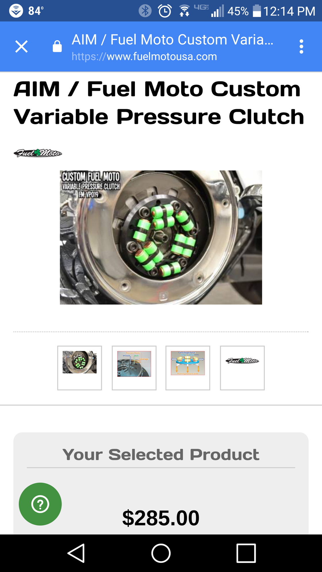

Thanks everyone, I'll take a look at all the setups you mentioned. Bike it's going in is a softail breakout. I ride solo. No bags or extras. I was looking at this aim unit and can add the barrnet spring.
