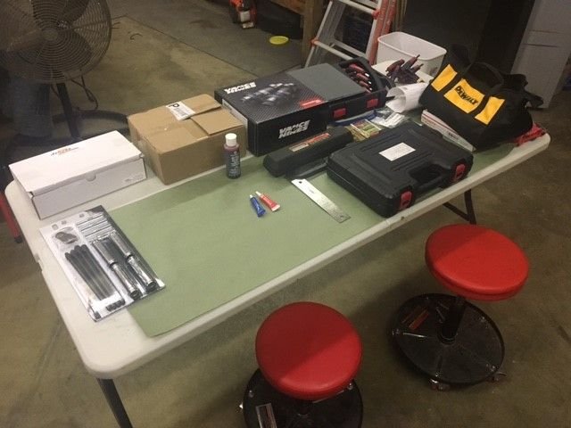

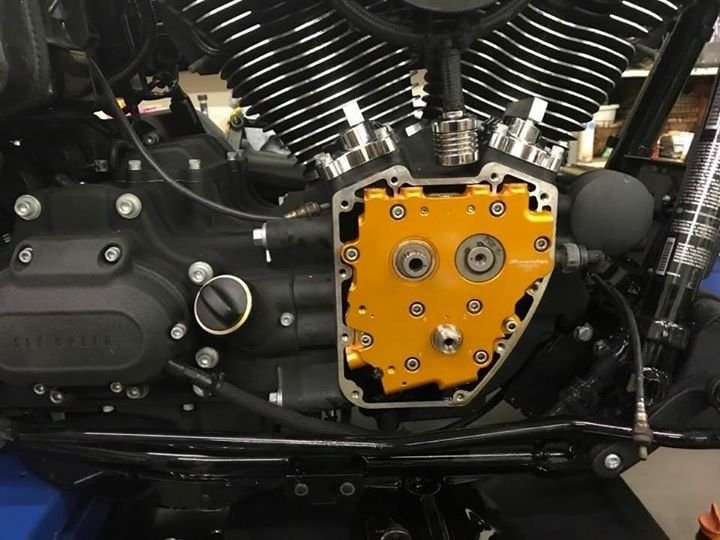

The install went awesome and taking my time, breaking for lunch and helping the wife clean up her yard sale it took me about 4 hours...
I used the Screaming Eagle Quickie pushrods, Screaming Eagle Hi output oil pump and cam plate, with the Vance and Hines 575 cams...
After install I uploaded the new map on the FP3 and went out riding...
I had a bit of sputtering on the low end so I decided to enter the autotune...
I ran auto tune 3 times applying each time afterwards (aprox an hour of riding each time.) I then finished auto tune and the bike ran GREAT...
on way home I had a couple of sputters rolling from 1st to 2nd so I called V&H Monday morning, uploaded them my latest map, they made some adjustments to the settings and sent me back a new map... Its been raining here so I have not had a chance to try the new map out yet.
Here are some of the photos and I will be uploading before and after video so you can hear the sound difference.

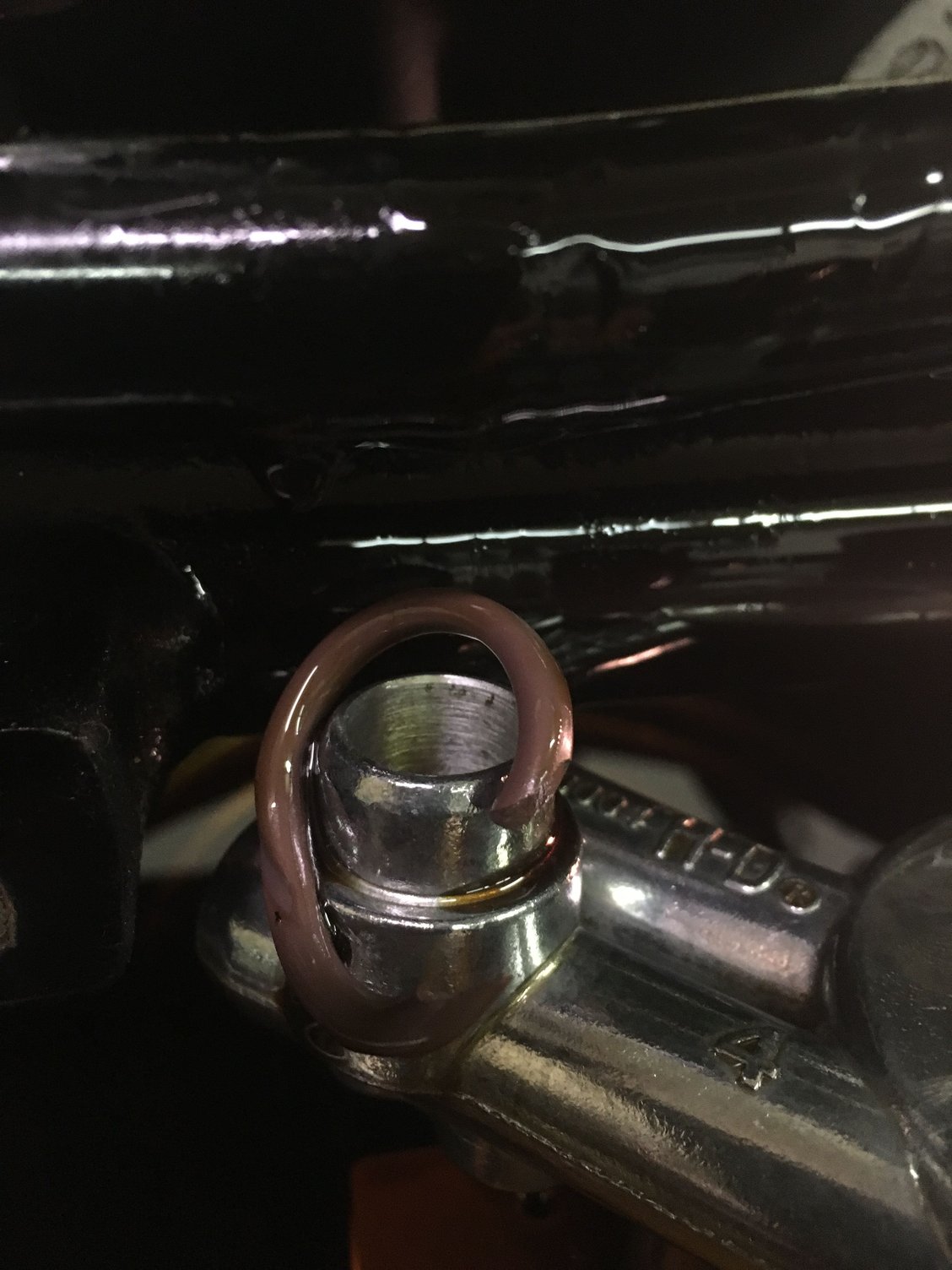

Butt dyno says I am looking into tearing it back down... Not right...
Bike seems slow... think I might have an oil scavenging issue... Rode it and the oil level went down (classic scavenging issue)
Pesky oil pump o-ring possibly
I Definitely have not seen an improvement in power anywhere thus far and I think that something just isn't right... I expected to be able to tell a good bit of difference...
I assumed changing the cams would do a bit more than change the sound...
Anyone else's feedback?
I know what I am doing today

Hope you get it worked out, you could run the bike a few minutes and cut the engine off before it Idles a bunch and pull the bottom drain plug from the bottom of the block and measure the oil, if it's 4 to 6 oz you shouldn't have a sumping issue, if it's more then yea, it's sumping. You will have to be very careful to not over tighten that plug on the bottom though, it's a pipe threads so it could crack the block if over tightened.

So here is the culprit as originally thought....
Suggestion
Use Grease to place the O-ring in the hole then put your oil pump together piece by piece assembling it inside... then put on your cam plate.
Pesky O-ring failure
