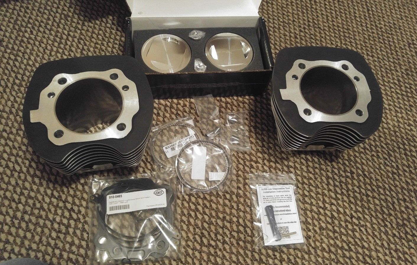

I have another set of ACR heads and then the 107 S & S cylinders and the 57 cams.
