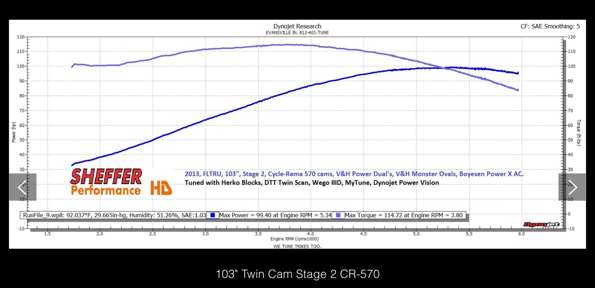

Numbers are on Sheffer's Performance page along with several dyno's with the 570-2's. I have seen the same. Flat tq curve. Last one I did popped over 100 at 2400 and carried out over 100 to 5000. Max was 107. 2-1 supermeg with disc tuned. Straight bolt in.
How many disc , closed or open endcap? Can you please post the Dyno Sheet.

36 disc closed end cap. IME they do not like an open.

Not knocking the cam, the designer or the dyno sheet but I would like to see it tuned by another on a 250i. There's not enough evidence except for one person one Dyno.....
If you're talking about Daren's dyno sheets, I don't know why this isn't "enough evidence". He obviously has lots of experience with the cams, plus the "one person, one dyno" assertion makes it a very consistent (and in my mind, valid) comparison, since all the dyno runs can be directly compared to one another (no "happy" dyno versus "conservative" dyno). Anyway, here's a sheet that Wes sent me, for the sake of comparison....
Stock Road Glide 103, versus same bike with cams and tune...
I know, Wes probably spent some time tweaking the tune to get the most out of it, but it still shows the potential.
