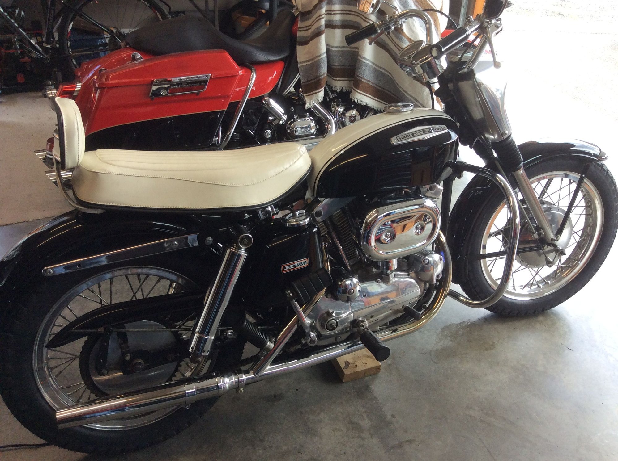

No breather Just air and gas but I did do that on my TC. This is the bike I am referring to

No Matt this isn't like the newer bikes as far as the head breathers. I have an issue with the internals be it rings guides or valves possibly all three but the motor is supposed to be "rebuilt". The top of the pistons also seem oily or wet a little bit so I have just put in a hotter plugs to prevent fouling. Bike runs pretty well and hope to make it to the fall before I go into the top end. With the compression at 130/135 I think that the oil must be coming in through the guides into the intake area and then into the combustion chamber. Does this sound logical? Thanks
