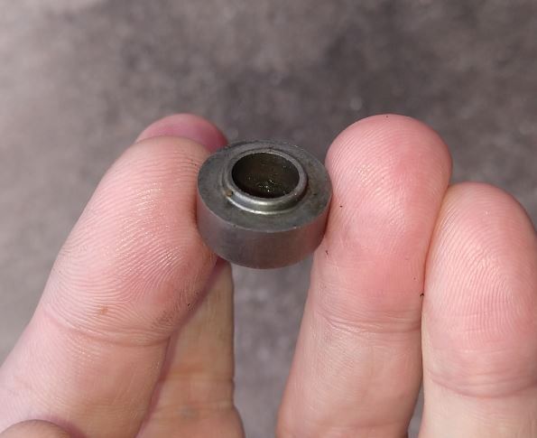

I am a forum lurker, not so much a heavy poster so you wont see much of me if I cannot help. But with this first post, I need some help and have run out of options. I bought a 2008 fatboy that needed a belt. The bike had been disassembled and I have accounted for all the parts except for one, the one in the picture. I have looked around the manual and have not had any luck locating it. I really don't want to put the bike together to find out it went behind the belt or something. My guess is just a cover spacer but that's just a guess. Any assistance would be appreciated. Thanks!

the fiche does not list it but is it the same bore as the axle threading, could be a cover like you said.

It is a spacer that goes behind the primary chain auto tensioner, and there should be 2 of them. One for each bolt

WINNER WINNER CHICKEN DINNER!! You sir get the gold star and my thank you for your assistance. I looked at the old chain tensioner and guess what I found stuck in the hole..Yep the other spacer. I bought a new tensioner and was about to install it. Glad I asked and glad you knew.

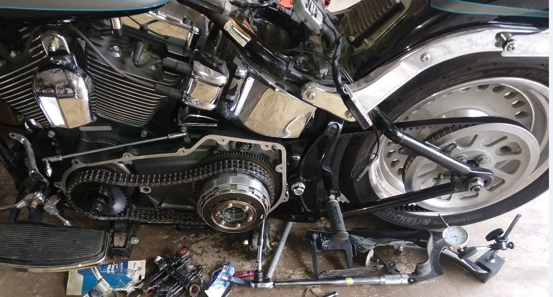

I’ve heard people claim those automatic tensioners overtighten, and can destroy the output bearing on the transmission. There is a hydraulic version. While you have it apart would be a good time to research it. I have an o6 and bought the automatic, the first time I was back in there it was very tight. I went back to the manual tensioner. That’s my opinion.

I bought the latest version of the automatic, 39929-06b. It had the A version in it and was worn enough that I wanted it replaced while I was in here. Hopefully I can get some miles out of it. I guess it all comes down to where the grooves click on the tensioner. Thanks for the suggestion though. I may go to manual if I have to go back in here.
