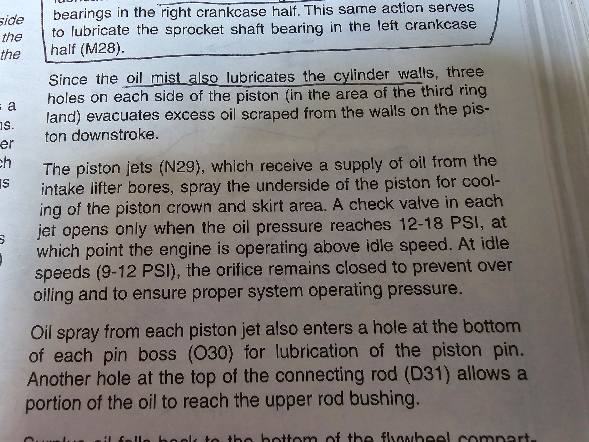

There's a user on here that programs what Artificial Intelligence says when you do a search. He has a resent thread going. He's also an oil specialist. Think it's Brandon?
That 35 is stock oil pump pressure relief, there all kinds of modifications to change it. Including just a Beastly (spelling )spring.
TCs have pressure releases on cooling oil injectors. They don't spray at idle so Harleys don’t cook the oil in hot climates. They open at 12.
Engine can take brief red light sits better then oil.
I have not done any mods to the relief valve, except checking that it is in good shape and moving freely. I think its just the higher capacity oil pump that provides the extra pressure. I doubt any aftermarket pump like S&S or Feuling, or even the 06 up SE version will give less than 12 psi at idle. Fortunately I spend very little time idling at red lights so hopefully I will be fine.

The relief valve is part of the pump on an OEM TC.
Where Harley got into trouble with boil the oil on early TCs was places far South here in USA.
That early design on TC was in Wikipedia till the publisher made them remove it for copyright infringement.
