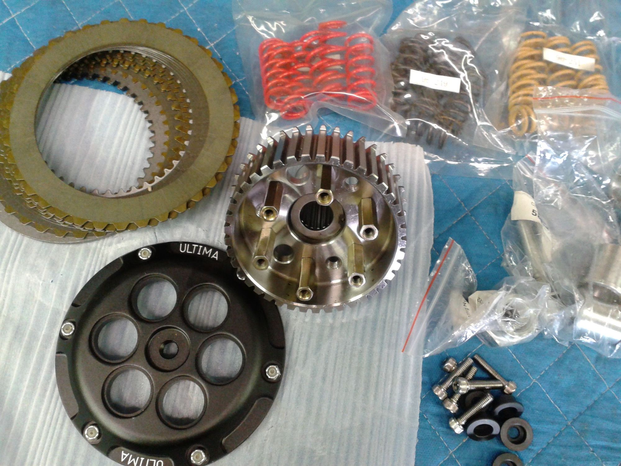

Not so much the plates are the problem ...
What we see a lot w/ the stock Evo clutch's when adding HP ....and depending on how much you Bang on it ...is that the plates are so thin and cause indentations in the stock aluminum hub ...and that makes them hard to slide which causes hard shifting and then adjustments don't help much anymore either ...
this is what we see a lot with the stock clutch hubs
this is a good upgrade...may not be the best but for the price ...works well ...steel hub and wider plates ...
