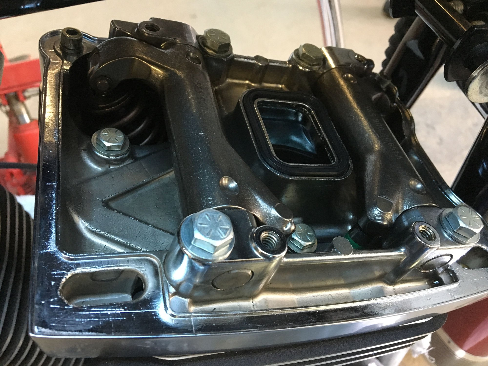

The controversial rollers? Hey I know they don't add ponies but l like them.

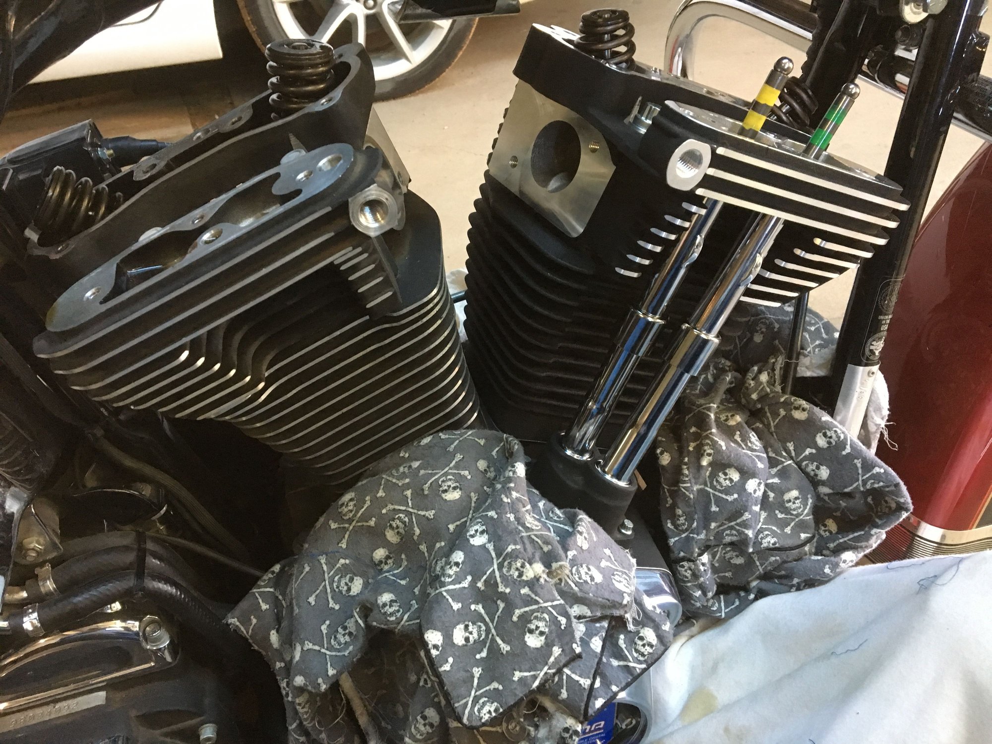

The cylinders are Axtell 85" with flat top pistons 9.5:1
Heads are 82cc chamber volume.
Cam is an Andrews EV13, which is good cruising at 55-65 mph however overall l find it a little underwhelming.
Ignition is Dynatek 2000i.
Carb (E) and manifold are S & S.
I wasn't looking for a massive boost in ponies just a nice improvement.
